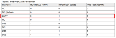

Please do not remove the jumpers of J45 and J20, connect directly to them with a male to male jumper. Please configure as well the onboard HOSTSEL switches accordingly.

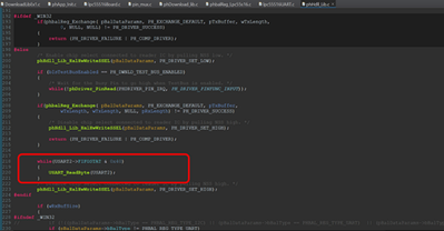

In the “phHdll_Lib_HalHwExchange” function please add the following lines to empty Rx FIFO:
In this same file include the "fsl_usart.h" library.

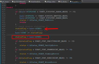

In fsl_usart.c::USART_ReadBlocking() please copy the line 625 and paste it again after clearing the reception flags.
After this, please test the project and the communication.
