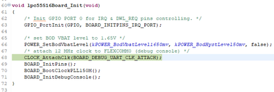

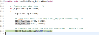

Besides the direct connections to J68, I could suggest confirming if Port 1 is already init during LPC55S16 Board initialization (i.e. GPIO_PortInit(GPIO, 1) ).
Also, please check if Flexcomm2 is clocked (i.e. CLOCK_AttachClk(kFRO12M_to_FLEXCOMM2) ).
Eduardo.

Yes, GPIO Port 1 is initialized.  The code executes as shown below.  However, this is the same for SPI mode (which I previously mentioned works fine) as DWL_REQ and IRQ are needed for that mode as well.
The Clock Attach code as you stated is NOT in the code.  "kFRO12M_to_FLEXCOMM2" is not used anywhere.  However there is a clock attach for a Debug UART.  I'm assuming this is NOT the port we would be using to connect to the PN7642 for HIF?
This is where we get stuck...in fsl_usart.c::USART_ReadBlocking()
The blocking transmit returns without error and then a read is attempted to retrieve the result and apparently there is nothing in the receive buffer.
Can you verify that this code has been tested and it will successfully connect to the PN7642 bootloader in download mode?
