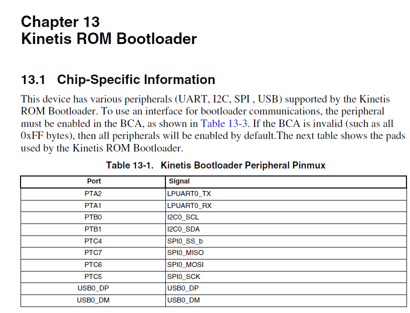

   K32L2Bxxx already contains the ROM bootloader:
   That's why the SDK didn't contains the MCUBOOT middleware.
   If you want to use the related tools, eg. blhost, elftosb,etc.
   You can go to the NXP mcuboot page download it:
MCU Bootloader | NXP
  You can try to use the KinetisFlashTool tool to download the code.
Wish it helps you!
