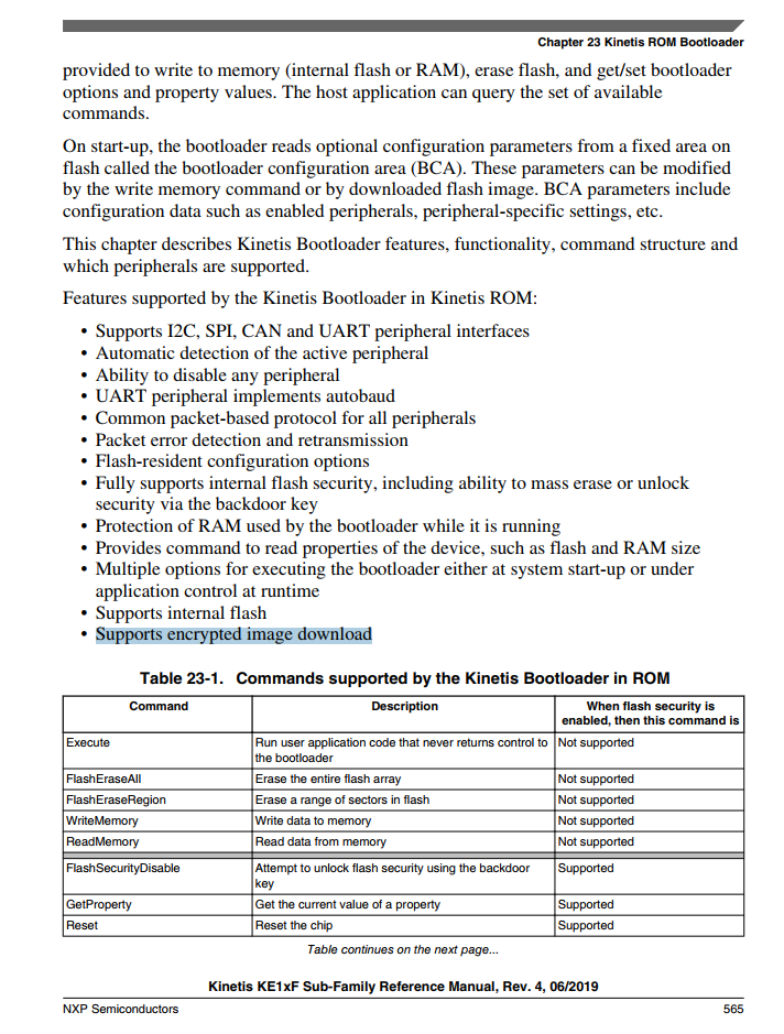

jordi_becares
Hi Jing,
thanks for the feedback.
About question 1, ok. I found the table of pins.
But, about question 2 In page 565 of RM I can't see any reference about pins.
I attached a snapshot of page 565.
Jordi
4,531 Views
jingpan
Hi Jordi,
Oh, my RM version is really old.
This is a copy for my version. Please see according page in your RM.
Jing
4,532 Views
jordi_becares
Hi Jing,
ok, so as a summary:
When enter in ROM bootloader (from API or from reset) all pins change to default value excepts the used pins for bootloader. Those pins related with peripheral set via BCA, will be configured as show in 23.1.1.
Is it correct?
Jordi
