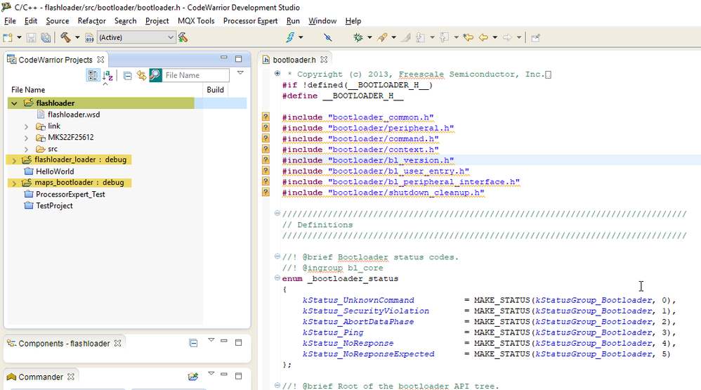

I have the following MCU: S9KEAZN64AMLH (KEA Family - ARM® Cortex®-M0+)
Given bootloader package NXP_Kinetis_Bootloader_1.2.0 for KS22 package from MCU Bootloader|NXP, I want to change some settings in the source code of that bootloader, build and upload binary file to MCU.
I have downloaded the package and I have imported the project into CodeWarrior workspace.
After project import, there a some things I don't understand:
1. Why are there three projects instead of one?
2. What are the configurations I have to make in order to be able to generate final bootloader image (probably .bin) which shall be uploaded on MCU?
PS: Is there any other IDE recommended for this or CodeWarrior should be fine?

The three project has different usage
 flashloader: This subproject is the core of project. This subproject is laid in RAM. Because when implementing flash operation, code must be laid in RAM. When boot up, flashloader_loader/tower_bootloader copys flashloader's image to ram.
 flashloader_loader: If you don't want to keep bootloader after download application, you can use this subproject. This code is laid in flash address0, and can be covered when download application. It need flashloader to be pre-compile.
tower_bootloader: If you want to keep bootloader after download application, you should use this subproject. You application should locate at 0xa000;
In fact, bootloader is default build in IAR/KEIL/KDS.

curiosul
Thanks! I finally managed to open that project correctly using KDS!
