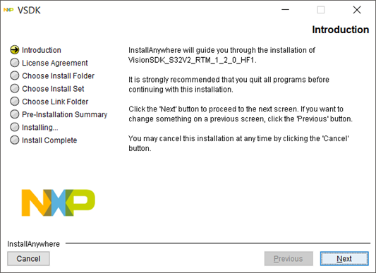

1. Download the Vision SDK RTM v1.2.0 on your PC. Due the size of the package this might take a while.
You may need to install additional Hot Fixes that are applicable for the Vision SDK

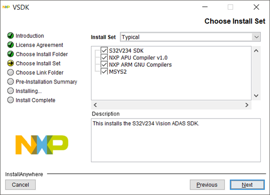

2. Once the executable file download is finished, select “Install VSDK and A53/APU Compilers” option in the Installer Guide UI or simply double click on the executable file.
3. Select the exe file and wait for the Vision SDK Install Anywhere to start.
3. Make sure you follow all the steps and install the:
  • NXP APU Compiler v1.0 – used to compile the generated code for APEX Vision Accelerator
  • NXP ARM GNU Compilers – used to compile the generated code for ARM A53
  • MSYS2 – used to configure the bootable Linux image and to download the actual vision application to the S32V234 Evaluation Board

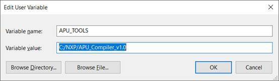

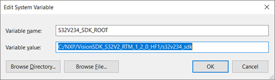

The last step required for software configuration is to set two system or user environmental variables APU_TOOLS and S32V234_SDK_ROOT that points to:
APU_TOOLS= C:/NXP/APU_Compiler_v1.0
S32V234_SDK_ROOT = C:/NXP/VisionSDK_S32V2xx_RTM_1_2_0_HF1/s32v234_sdk
Ensure system or user environment variables, corresponding to the compiler(s) you have installed, are defined to compiler path value as shown below:
Note: Paths shown are for illustration, your installation path may be different. Once environmental variables are setup you will need to restart MATLAB to use these variables.
An alternative for settings the system paths manually is the “Set the environment variables” option from the NXP Vision Toolbox support package installer:
Note: If the MATLAB is open with Administrator rights, then the “Set system wide” can be used to set the system variables. Otherwise (most of the cases) use “Set user wide” to setup the environment variables.

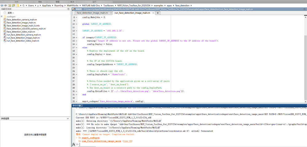

Hi Daniel,
We encountered problem when building the example. Could you help to check what's the problem?
9,326 Views
paulvlase
Hi terrytan‌,
The build system from VSDK doesn't support spaces in paths. Please follow the instructions from https://community.nxp.com/thread/488801#comment-1086053 , change the path where the Matlab Add-Ons are installed to one that doesn't contain spaces, and reinstall the NXP Vision Toolbox.

terrytan
Hi Paul,
After correct the space path, we encountered another problem. Could you check the picture attached?

paulvlase
Hi terrytan‌,
Which SDK are you using? The NXP Vision Toolbox for S32V234 supports only VSDK 1.2.0 HF1 with HF2 applied.

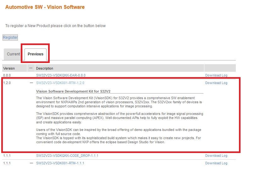

terrytan
Hi Paul,
We used SDK 1.3. But we can only don’t SDK1.3 from NXP website.
Could you suggest where to download VSDK 1.2.0 HF1 with HF2 applied?

paulvlase
Hi terrytan‌,
There should be a "Preivous" tab when you download the VSDK 1.3.0 fron nxp.com

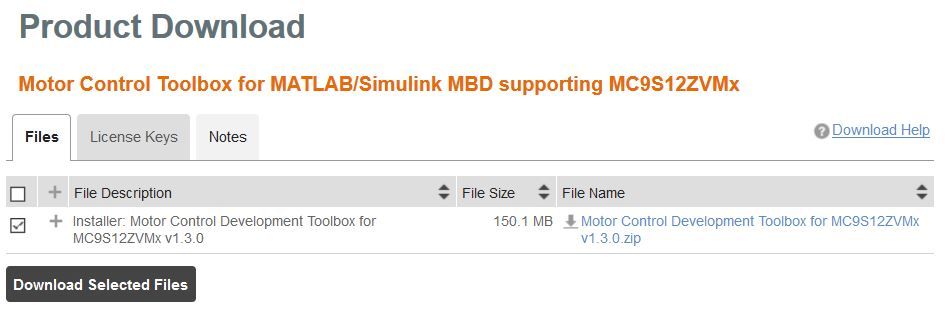

dmeng1
Dear Daniel:

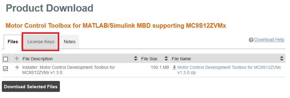

Could you tell me how to install Motor Control Development Toolbox for MC9S12ZVMx v1.3.0 on matlab simulink ?
I have watched the viedo abou how to install S32K toolbox on matlab simulink. I tried to install the MC9S12ZVMx Toolbox like S32K toolbox , but I failed many times. could you give me a detail steps about how to install the MC9S12ZVMx Toolbox on simulink. thanks very much.
Best wishes
9,323 Views
paulvlase
Hi [email protected]‌,
Motor Control Development Toolbox for MC9S12ZVMx v1.3.0 is not shipped as a Matlab package.
To install the toolbox follow this steps:
1. Download the Motor Control Development Toolbox for MC9S12ZVMx v1.3.0.zip file from nxp.com website.
2. Unzip the file
3. Follow the instructions from Motor_Control_Toolbox_Installation_Quick_Start.pdf file, from the unzipped folder.
4. Run the setup.exe and install the toolbox to C:\MCToolbox\ for example.
5. Open Matlab and change the Matlab current directory to toolbox installation folder, C:\MCToolbox\mctbx_9s12zvm.
6. Run mcd_s12zvm_path Matlab script.
>> mcd_s12zvm_path
Treating 'C:\MCToolbox\mctbx_9s12zvm' as MCD Toolbox installation
root.
MCD Toolbox path prepended.
Successful.
7. In Command Window, enter mcd_s12zvm_hostid. The returned code is the Host ID.
8. Get the license file from the toolbox download web page.
9. Copy the license.lic license file to C:\MCToolbox\mctbx_9s12zvm\lic
9,323 Views
dmeng1
Dear paul:
Thanks very much , I have installed the Motor Control Development Toolbox for MC9S12ZVMx v1.3.0  successfully.
