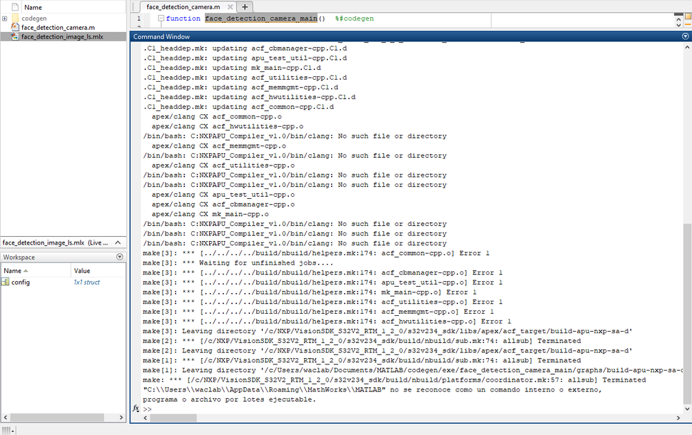

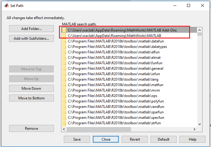

Hello everyone, I have already been able to configure the Matlab environment with the NXP.
But at the time I try to load the program "face_detection_camera_main" to the Board, I get the following error.
"C: \\ Users \\ waclab \\ AppData \\ Roaming \\ MathWorks \\ MATLAB" is not recognized as an internal or external command, program or batch file executable.
I have already tried adding the Path (as shown in the image) but in spite of that it does not work.
If you could help me, it would be very useful.

Daniel_Popa
Hi willcampo@hotmail.com‌,
Can you paste here the MATLAB console output (all of it) please.
I think we have an issue with some white spaces in the path. In general NXP Vision SDK needs to installed in a path without spaces.

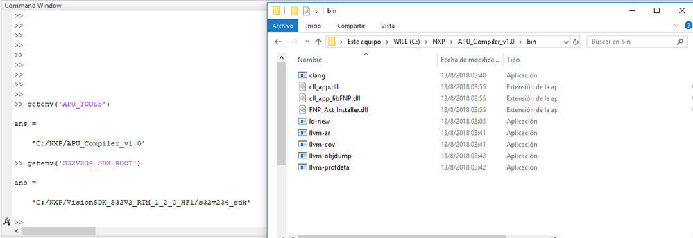

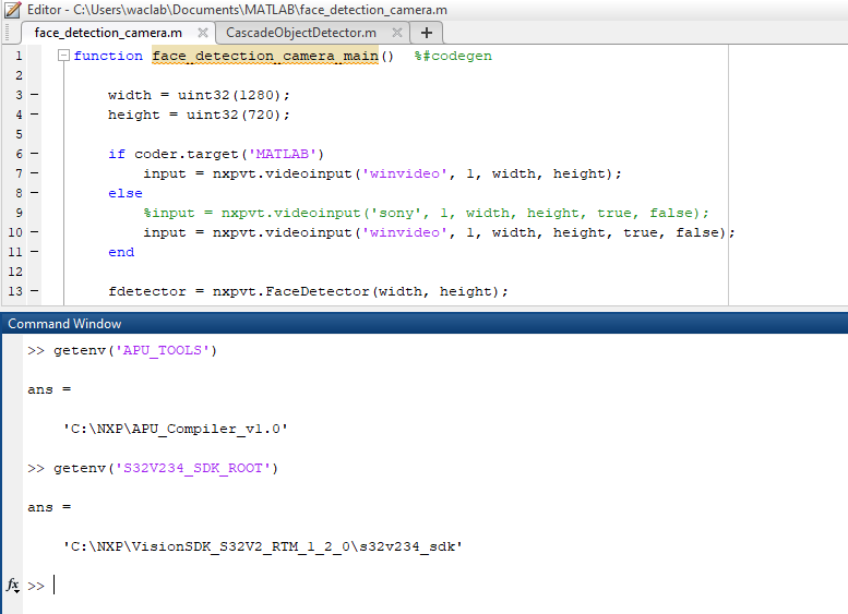

paulvlase
Can you show us the output of the following commands run in Matlab command line?
getenv('APU_TOOLS')
getenv('S32V234_SDK_ROOT')
5,168 Views
willcampo
5,168 Views
paulvlase
The nbuild system from VSDK expects forward slashes / in the paths from these two environment variables. We'll fix this in the next release.
Can you replace \ with / in APU_TOOLS and S32V234_SDK_ROOT and try again?

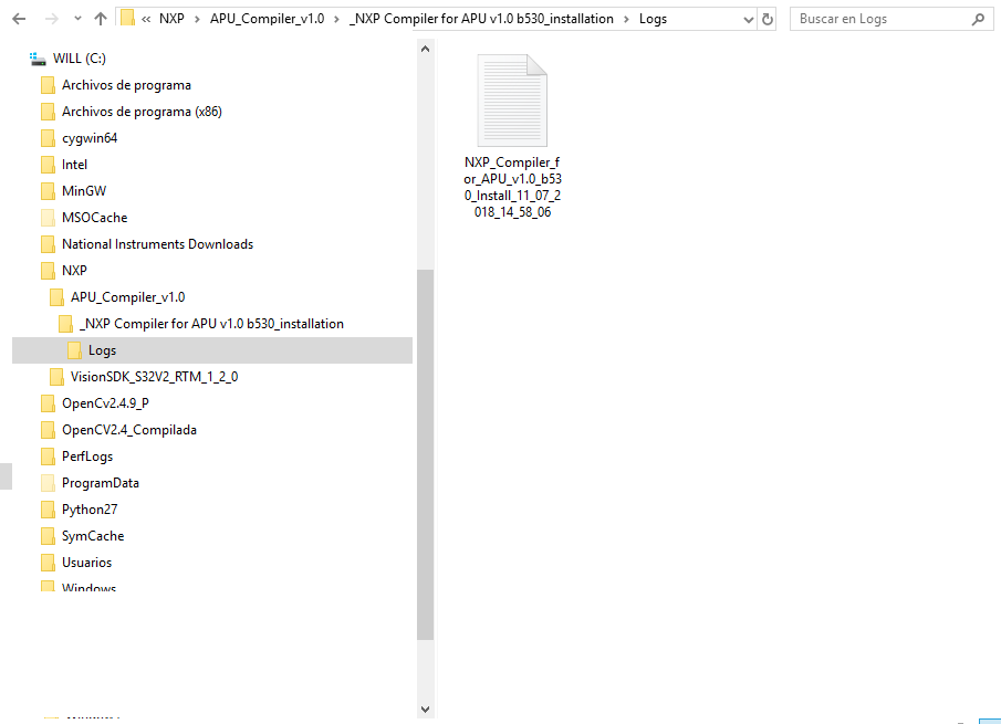

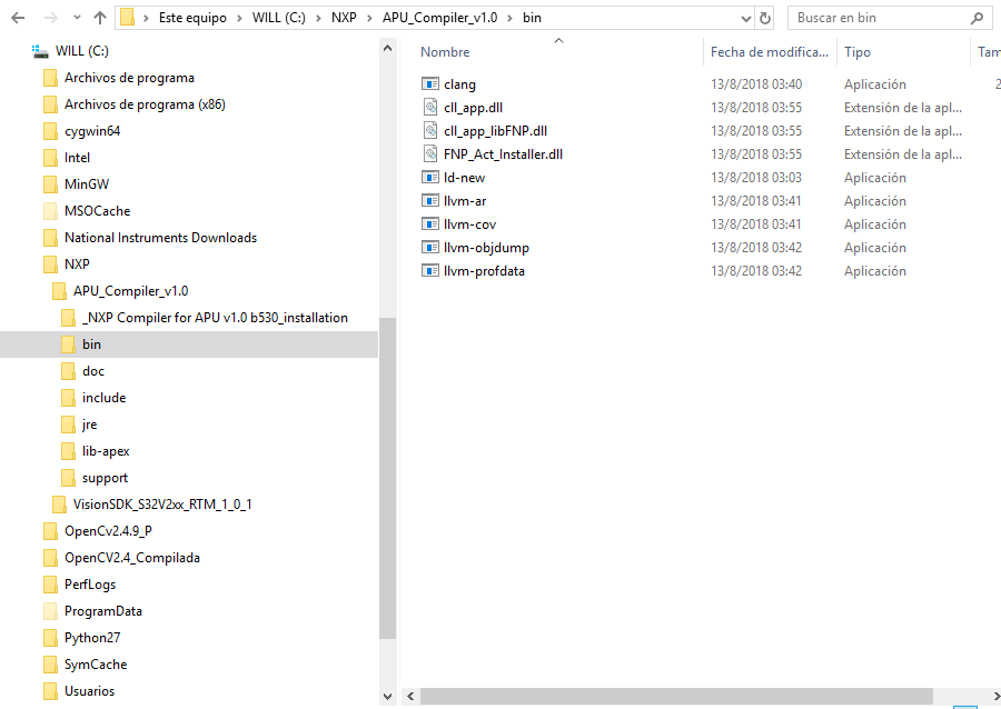

paulvlase
Can you show me the content of C:\NXP\APU_Compiler_v1.0\bin folder in explorer, as a screenshot?
5,168 Views
willcampo
The only thing that is in this folder is this file
5,168 Views

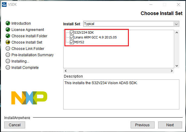

Daniel_Popa
Hi Willian,
I see 2 main issues with your setup.
First of them: the Vision Toolbox currently available for download supports only VisionSDK 1.1.0
You have installed the VisionSDK 1.2.0 which can't be used in conjuction with the MATLAB toolbox since they are not compatible. There were changes in 1.2.0 which are no longer compatible with 1.1.0 version.
The good news is that on November 19, we are going to release the new version of the Toolbox that will be in sync with 1.2.0 VSDK + HF1 + HF2. Can you wait until next week.
Secondly, the APEX compiler is not installed correctly. You should have more files in that folder.

willcampo
Hello again,
I searched for the version VisionSDK_S32V2_RTM_1_1_1, but I could not find it, I only found the version VisionSDK_S32V2xx_RTM_1_0_1_8d46d3.
But when it comes to the installation, I can not install the NP APU_Compiler_v1.0

willcampo
I have uninstalled VisionSDK_S32V2_RTM_1_2_0
and now I have installed VisionSDK_S32V2xx_RTM_1_0_1_8d46d3 and separately the compiler APU_Compiler_b530.
(I have made the changes mentioned above as well)
Now the contents of the folder C: \ NXP \ APU_Compiler_v1.0 \ bin is as follows.
The error still remains.
C: \\ Users \\ waclab \\ AppData \\ Roaming \\ MathWorks \\ MATLAB " is not recognized as an internal or external command,
5,116 Views

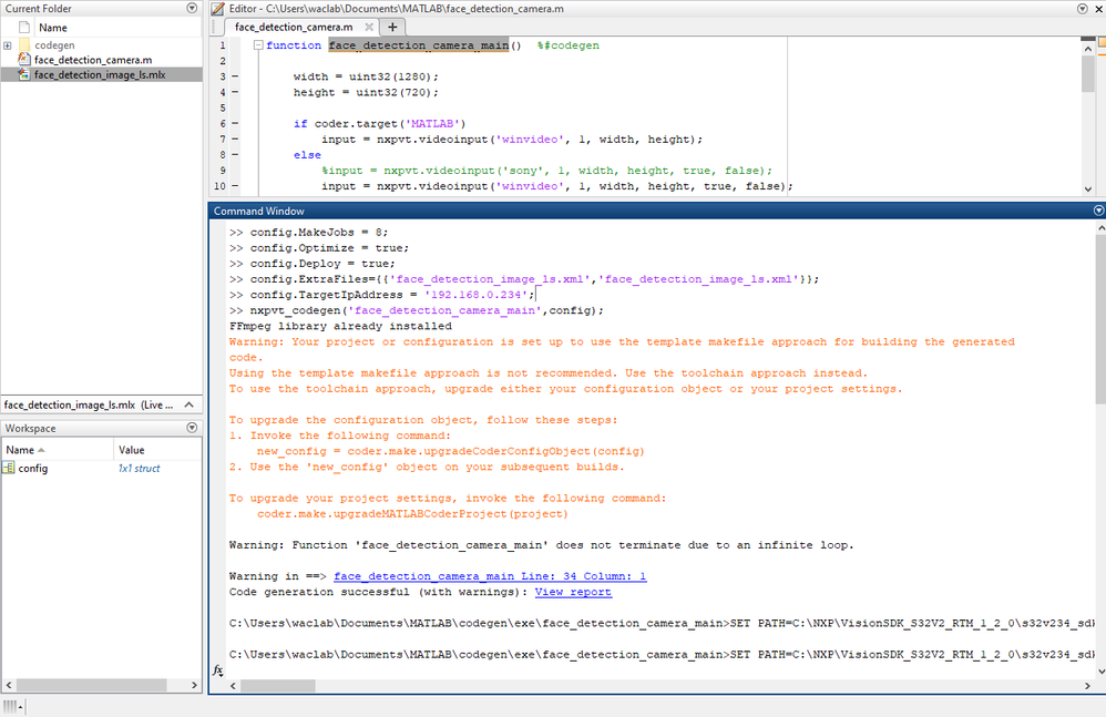

willcampo
I downloaded and installed  VisionSDK_S32V2_RTM_1_2_0_HF1
But what I get when trying to load the program is the following,
5,119 Views
paulvlase

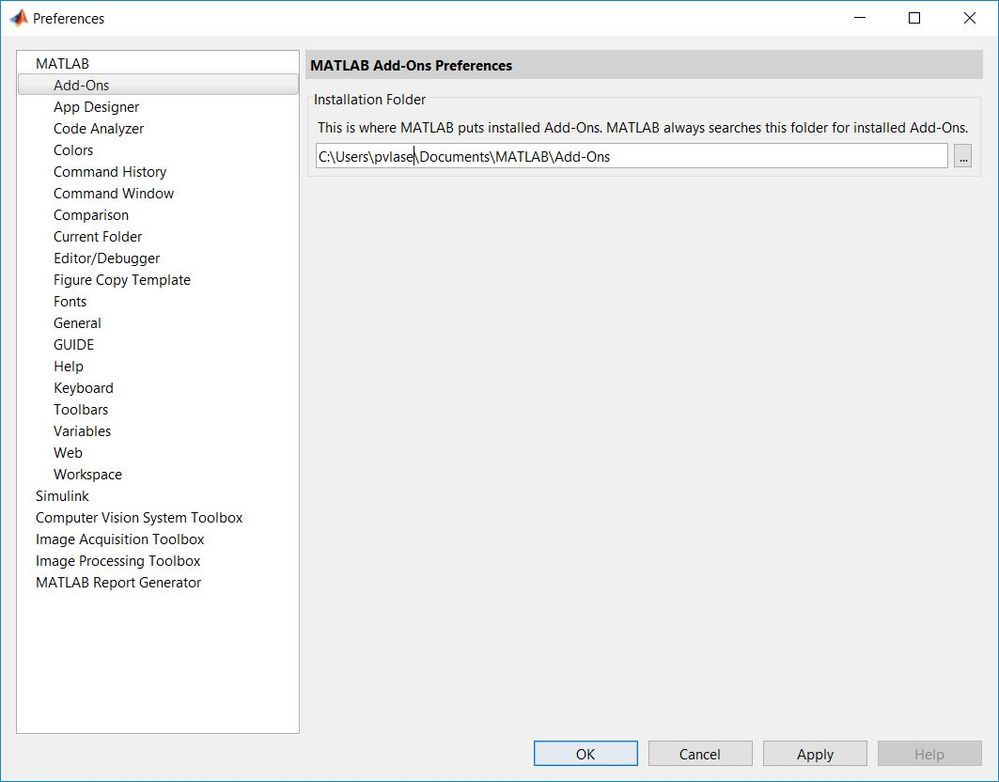

Hi willcampo@hotmail.com,
The build system from NXP VSDK doesn't support spaces in paths.
To make it work you need to change the path where the add-ons are installed from the Matlab Preferences window.
Set a path that doesn't contain spaces.
5,119 Views

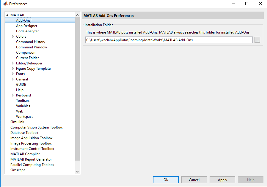

willcampo
What should change in this case?
5,119 Views
paulvlase
You could replace "MATLAB Add-Ons" folder with "MATLAB_Add-Ons" (notice the "_" instead of " " character)
It should look something like this: C:\Users\waclab\AppData\Roaming\MathWorks\MATLAB_Add-Ons
5,119 Views

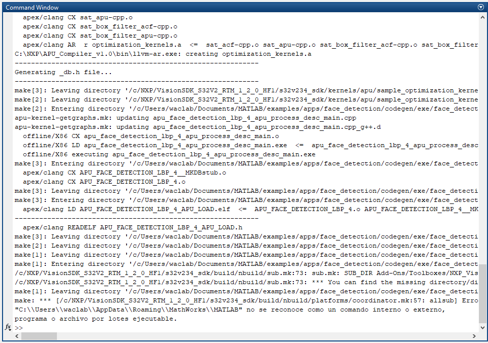

willcampo
Thank you. Finally, that error no longer appears.
But at the end of compiling the whole program, this message appears, and I can not capture any image with the camera.
5,119 Views
paulvlase
I think we are back to the previous problem with the APU compiler folder instalation empty.
Could you run getenv('APU_TOOLS') in matlab command line?
And check the content of C:\NXP\APU_Compiler_v1.0\bin folder?
5,119 Views
willcampo
