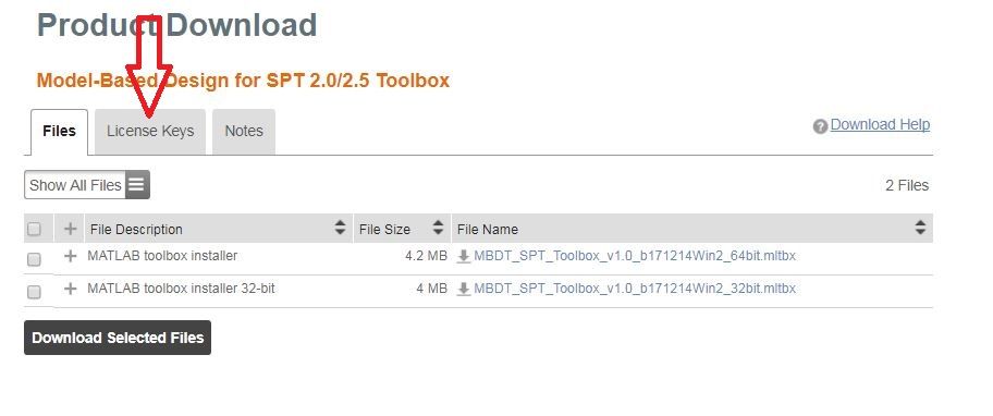

As explained in the video here (starting at ~ 0'40''), if you check one of the corresponding checkboxes (either for 64 or 32bit) and then click on "Download Selected Files", you should be downloading a .mltbx file. There is an issue if you just click on the file name, it starts downloading a .zip instead. The file should be the same, just the extension being altered. If you are having trouble with the download, you should consider using Internet explorer to do it. That is the recommended browser.
Second, about the licensing issue you're having, I can't reproduce it locally - can you try again, following the steps explained here (starting at ~1'45'') - you should execute this steps:
1) Go to License Keys first
2) Check the checkbox highlighted and click on Generate button.
3) Open cmd and run the vol command; it should output something like this
          Volume in drive C is Primary
          Volume Serial Number is D8D9-8EB6
      Get the serial number and enter it (as highlighted in the image below); enter a name and then click on Generate button.
4) Save the license by either clicking on Save All, either by coping all the text below and create a license.dat file in the license folder.
Please let me know if you're still having trouble with this (and if so, please specify what MATLAB version you are using - so I can have a better chance of reproducing your exact error).
