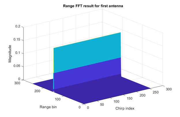

% Perform Range FFT
% For each line a FFT is performed. The negative frequencies are discarded.
% The frequencies with significant magnitudes indicates the presents of an
% object at a specific distance. The distance is proportional with the
% frequency.
% Non bit-exact model
exwindow_rangeFFT = repmat(window_rangeFFT, [1, N, P]);
output_rangeFFT = fft(input_data .* exwindow_rangeFFT, [], 1);
output_rangeFFT = output_rangeFFT(1:end/2, :, :) / M;
% Bit-exact model
output_rangeFFT_bitexact = rangeFFT(input_data_rs * 2^(NBITS-1), window_rangeFFT_rs * 2^(NBITS-1), twiddle_rangeFFT * 2^(NBITS-1), M, N, P);
output_rangeFFT_bitexact = output_rangeFFT_bitexact / 2^(NBITS-1);
Figure 8 Range FFT Results
