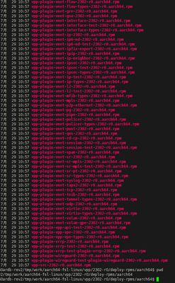

I refer to section 8.3.4.2 of the LLDP_6.1.55_2.2.0 documentation for the build vpp,used command:bitbake vpp,a very large number of rpm packages related to vpp have been generated in the following folder。
1、is this normal?Because in lsdk21.08, vpp will only generate 9 relevant deb package files.
2、How do I install vpp?
/root/yocto/build_lx2160ardb-rev2/tmp/work/aarch64-fsl-linux/vpp/2302-r0/deploy-rpms/aarch64

Yes  it is normal because is the dependencies of yocto and your apps. if you are in yocto, you have to build the whole package once it added to it.
regards

Yes,i build vpp in yocto system,and i just run this command:bitbake vpp.
How do I take the compiled vpp and install it on the lx2160?
