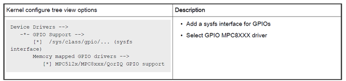

Linux Kernel configuration is as the following.
