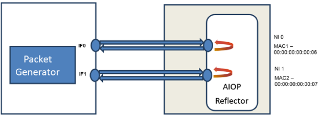

HI All,
I am trying to run the packet reflector AIOP app on my LS1088ARDB board.
I did follow the instructions from LSDK Reference Manual Rev. 18.09 Section: Running the Reflector Application. Section nubmer:   8.3.7.1.2.2
Here are the steps presented in the manual:
./dynamic_aiop_only.sh
#aiop_tool load -g dprc.3 -f /usr/aiop/bin/aiop_reflector.elf &
#cat /dev/fsl_aiop_console | grep REFLECTOR
#busybox tail –f /dev/fsl_aiop_console   => This step does not show the results presented in the LSDK Refence manual. See the attached busybox.PNG.
I am not sure what I am doing wrong here. Please find the attached log of the commands aiop_reflector_log.txt

yipingwang
Hello Janarbek Matai,
It's seems that your test result is normal, please refer to the following log with LSDK 1812 images.

When using a Packet Generator to inject traffic, connect one port of the packet generator to MAC1 of RDB-1 and a second port to MAC2 of RDB-1.
During frame processing, the AIOP Logger will print the following brief information about every reflected packet:
       NI ID on which the frame was processed
      AIOP Core number on which the task executes
      Received IP source and destination addresses
