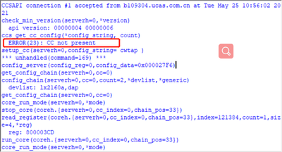

yipingwang
Would you please open CCS(CodeWarrior Connection Server) console, type "log v" command, then connect to the target board again? The low level CCS log will be printed. Please capture the CCS log and attach it to this thread.

The attachment is the log, but the previous contents seem to have been flushed out..
There was a mistake at the beginning:

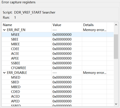

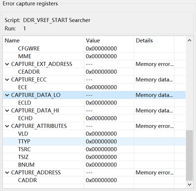

yipingwang
Would you please provide Error capture registers values?
11,043件の閲覧回数
muaxi8
Contributor V
 this is the  Error capture registers values...there valuse are all 0x0
