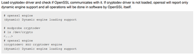

root@localhost:/usr/bin# modprobe cryptodev
root@localhost:/usr/bin# ls /dev/crypto
/dev/crypto
root@localhost:/usr/bin# ./openssl engine
(dynamic) Dynamic engine loading support
I have faced few error in caam and cryptodev in dmesg after loading caam and cryptodev module, due to this may be CAAM offload is not happening or else, can you guide me to offload.

I am not getting the cryptodev engine in OPENSSL like below
Can you provide a neccessary details to fix this issue. Looking forward for your response.
