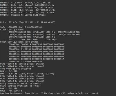

On LS1088A platform, based on LSDK20.04 version, using onboard particle DDR4 design, the model MT40A512M16LY-075 (64 bit width +8 bit ECC, 4GB in total, 4 pieces of 512M*16 bit DDR4), DDR4 running at 1600MHz, has been produced at present .C file, please see the attachment for details.
The operation process is as follows:
  1.  Imported DDR register value, add the values in the generated ddrtfa_1.c file to the ddr_init.c file in the ATF folder as CONFIG_STATIC_DDR in section 5.2.3 of LSDK,
  2. Copy all contents of the generated uboot_ddr1.c file to DDR. C file in the u-boot folder,
  3. 3. Compile ATF and U-Boot folders in Linux interface, then synthesize image and burn it into NOR flash.
Enable static DDR, Open the # define CONFIG_STATIC_DDR
Refer to the RM file 2.2 System Memory Map and set the starting address to 0x0080_8000_0000.
Use DDR Region #2 as recommended, which is DRAM1 in the code,  Please refer to attachment 1:
Switch to DRAM1 completely in the BL2 setup file, Please refer to attachment 1:
In setup of BL31, change addr to 80_80000000 and size to 0x100000000//4GB, Please refer to attachment 1:
RCW modifies DDR multiplier to 16, modifies DDR_REFCLK_SEL=0, and selects single-ended DDRCLK input clock,Please refer to attachment 1:
After the compilation is completed, the printed information is Please refer to attachment 1 :
Please check whether the current process is correct and how to modify it. Please help.

we are having a DDR4 size problem on LS1088a platform.  We have 4GB DDR4 on the board. When u-boot starts it is confirmed that board has 4GB DDR4. But when we checked on kernel with cat /proc/meminfo or free commands, it shows that RAM is 2GB.  We did tried what @yipingwang post but nothing changed.
Do you have any idea why are we having mismatch DDR size in u-boot and kernel ?
Attached photos you can see the differences.
Thanks.

If you want to use fixed DDR registers configurations to initialize DDR controller, you need to define CONFIG_STATIC_DDR in platform_def.h, define function board_static_ddr and structure ddr_cfg_regs in plat/nxp/soc-ls1088/ls1088ardb/ddr_init.c in atf folder. You could refer to plat/nxp/soc-ls1046/ls1046ardb/ddr_init.c.

8,030 Views
suezure
Hello, yipingwang
Refer to ddr_init.c in atf\plat\nxp\soc-ls1046\ls1046ardb, I found that:
size = 0x200000000UL; //8GB
simultaneously in atf\plat\nxp\soc-ls1046\ls1046ardb\platform_def.h, I found that:
#define PLAT_DEF_DRAM0_SIZE 0x80000000 /* 2G */
It seems that PLAT_DEF_DRAM0_SIZE is not required modify when ddr is over 2GB, even though reference manual chapter 2.2 described GPP DRAM Region #1 is 0~2GB at start addr 0x8000_0000
8,023 Views
yipingwang
Yes, no need to modify PLAT_DEF_DRAM0_SIZE.
