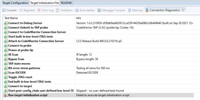

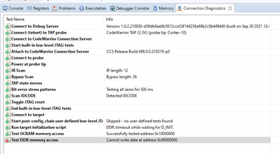

Trying to debug a bare-board project on an LS1046ARDB, I followed these steps...
7,029 Views
Daves_Garage
So the solution to this problem is the initialization of the DDR memory, which is sort of what the Connection Diagnostics terminal window was trying to tell me - It couldn't write data at address 0x80000000...that's because the DDR wasn't setup correctly.
Seems odd to me that the initialization script that comes with the Target Connection specifically called LS1046ARDB doesn't work with the LS1046ARDB...  just sayin'...
Anyway, running the DDR utility on the LS1046ARDB, and using it to generate the ddrCtrl_1.py file that it can generate, then copying the content of that file into the initialization script for the Target Connection, and running the connection diagnostics again, generates this result:
Problem solved...

Daves_Garage
Problem solved...

Made a little progress on this, but still having an issue with the initialization script in the Target Configuration.
Rerunning the connection diagnostics, I get this:
I could sure use some help with this.

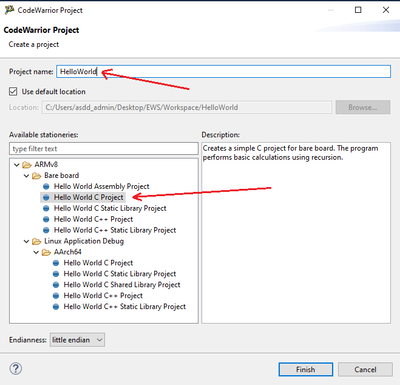

woops, for to post the steps... Here they are:
Before flash programming with CodeWarrior, you must create a "Hello World" ARMv8 bare-board project and use it to connect.
From Workbench, follow these steps:
Setup a project
  • Select File->New->CodeWarrior Stationry, then select the "Hello World C Project"
    • Give the project the name "HelloWorld"

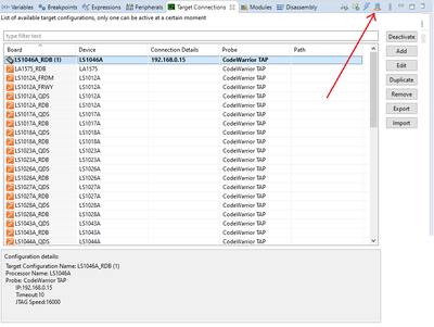

  • Select Windows->Show View->Other, then select Debug->Target Connections
  • Right click on LS1046A_RDB and "Duplicate" it - it will offer the name "LS1046A_RDB (1)"; use it
  • Double click this configuration from the list now (it's bold)

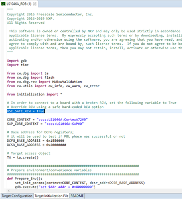

  • At the bottom of the window, select "Target Initialization File" tab, which opens up the code used to initialize the system
    • Change USE_SAFE_RCW = False to USE_SAFE_RCW = True
    • this is important, as there is no RCW yet in bare metal project Looks like this:

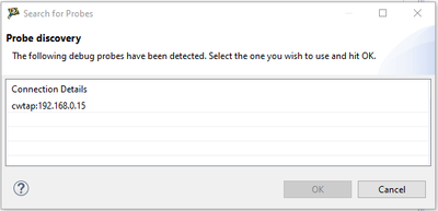

  • Verify you can find the TAP module by pressing the flashlight icon in the "Target Configuration" tab
  • A successful connectioin will show this:
  • Select the connection under "Connection Details", and press "OK" button

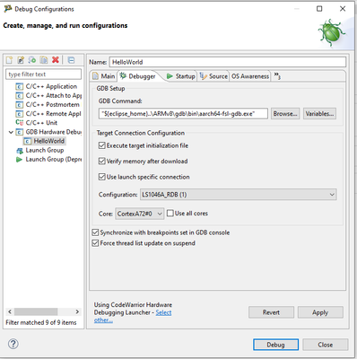

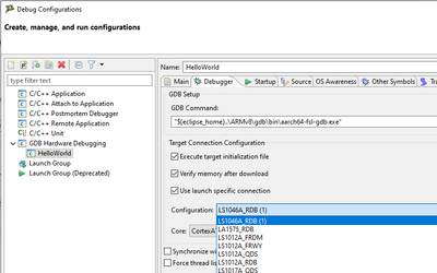

  • Select Run->Debug Configurations->GDB Hardware Debugging->HelloWorld, then on the tabs select Debugger.
  • Under the section "Target Connection Configuration", check all 3 boxes, and for the Configuration file, use the drop down to find the one you just created above (LS1046A_RDB (1)) and select it
    • If you are having issues with DDR memory, the whole "verify memory after download" is going to fail, since debugging occurs in DDR memory - in otherwords, if your DDR memory isn't configured right, the debugging session won't be working...
  • For "Core:", select the first core (Cortex A72#0)
  • Finally, select both "Synchronize with breakpoints" and "Force thread list update" boxes
  • Your final configuration should look like this:
  • SAVE IT by pressing the "Apply" button

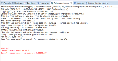

Debugging (not working)
  • Start debugging by pressing the "Debug" button
  • USE CONNECTIOIN DIAGNOSTICS
  • At the top right corner of the "Target Connections" window, there is an icon that looks like this:
  • Press it, and open the Connection Diagnostics terminal window to see what's going on...
... and this is as far as I get...
I could use some help
