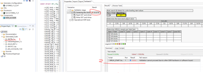

Hmc510
LS1046 DDR 8G . 1800MT
I modified the code in project ATF with ddrTfa_1.c
DDR validation:

Hi @Hmc510,
There are few possible reasons for the error as mentioned below:
  1. The training sequence that the controller follows to calibrate the read data path was not able to complete. This would probably only happen if there was a hard failure on the memory interface caused by board-level issues or incorrect controller settings.
  1. Incorrect termination of MDICx signals.
  1. Write leveling calibration was not able to complete. This relates to improper settings of the DDR_WRLVL_CNTL register or board-level issues.
