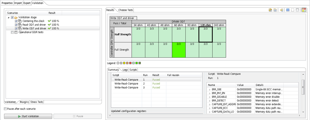

yipingwang
Hello hakjun oh,
You could use QCVS DDRv tool to validate and optimize DDR controller initialization parameters.
Would you please try your new generated ATF image on LS1043ARDB to check whether you encounter similar problem as booting from RGW?
Yiping

hakjunoh
Yiping.
I found reason of failed DDR validation in Codewarrior DDRv. It should have set DQ values. I didn't know if there was this option.
Either way, the results are good. Now I should check if there is any DQ setting in the ATF source.
RGW DDR Validation

hakjunoh
Hi Yiping.
The problem has been resolved.
plat/nxp/soc-ls1043/ls1043ardb/ddr_init.c
diff --git a/plat/nxp/soc-ls1043/ls1043ardb/ddr_init.c b/plat/nxp/soc-ls1043/ls1043ardb/ddr_init.c
index 705adb014..776204d57 100644
--- a/plat/nxp/soc-ls1043/ls1043ardb/ddr_init.c
+++ b/plat/nxp/soc-ls1043/ls1043ardb/ddr_init.c
@@ -92,33 +92,33 @@ int ddr_board_options(struct ddr_info *priv)
      return 0;
/* DDR model number: MT40A512M8HX-093E */
struct dimm_params ddr_raw_timing = {
      .n_ranks = 1,
      .rank_density = 2147483648u,
      .capacity = 2147483648u,
      .primary_sdram_width = 32,
      .n_row_addr = 15,
      .n_col_addr = 10,
      .bank_group_bits = 2,
      .burst_lengths_bitmask = 0x0c,
      .tckmin_x_ps = 938,
      .tckmax_ps = 1500,
      .caslat_x = 0x000DFA00,
      .taa_ps = 13500,
      .trcd_ps = 13500,
      .trp_ps = 13500,
      .tras_ps = 33000,
      .trc_ps = 46500,
      .twr_ps = 15000,
      .trfc1_ps = 260000,
      .trfc2_ps = 160000,
      .trfc4_ps = 110000,
      .tfaw_ps = 21000,
      .trrds_ps = 3700,
      .trrdl_ps = 5300,
      .tccdl_ps = 5355,
      .refresh_rate_ps = 7800000,
+    .dq_mapping[0] = 0x15,
+    .dq_mapping[1] = 0x36,
+    .dq_mapping[2] = 0x15,
+    .dq_mapping[3] = 0x35,
+    .dq_mapping[4] = 0x15,
+    .dq_mapping[5] = 0x36,
+    .dq_mapping[6] = 0x16,
+    .dq_mapping[7] = 0x36,
+    .dq_mapping[8] = 0x1,
+    .dq_mapping[9] = 0x21,
+    .dq_mapping[10] = 0x0,
+    .dq_mapping[11] = 0x0,
+    .dq_mapping[12] = 0x0,
+    .dq_mapping[13] = 0x0,
+    .dq_mapping[14] = 0x0,
+    .dq_mapping[15] = 0x0,
+    .dq_mapping[16] = 0x0,
+    .dq_mapping[17] = 0x0,
+    .dq_mapping_ors = 0,
      .rc = 0x1f,
Thank you very much.
