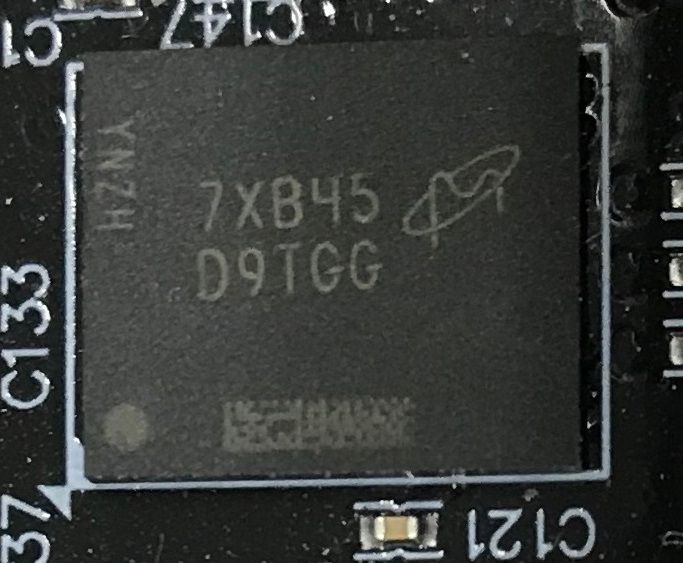

hakjunoh
Hi Yiping.
So, is the RAM timing problem the reason why BL2 Image is read from 0x10_0008 when LS1043ARGW is booted?
hakjun oh

hakjunoh
Yiping.
Unfortunately, the ram timing value has been changed, but the same message is output.
The source uses the MT40A512M8HX-093E, but our custom board uses the MT40A512M8RH-083E.
The changes are as follows.
plat/nxp/soc-ls1043/ls1043ardb/ddr_init.c
diff --git a/plat/nxp/soc-ls1043/ls1043ardb/ddr_init.c b/plat/nxp/soc-ls1043/ls1043ardb/ddr_init.c
index 705adb014..776204d57 100644
--- a/plat/nxp/soc-ls1043/ls1043ardb/ddr_init.c
+++ b/plat/nxp/soc-ls1043/ls1043ardb/ddr_init.c
@@ -92,33 +92,33 @@ int ddr_board_options(struct ddr_info *priv)
      return 0;
-/* DDR model number: MT40A512M8HX-093E */
+/* DDR model number: MT40A512M8RH-083E */
struct dimm_params ddr_raw_timing = {
      .n_ranks = 1,
      .rank_density = 2147483648u,
      .capacity = 2147483648u,
      .primary_sdram_width = 32,
-     .n_row_addr = 15,
-     .n_col_addr = 10,
+    .n_row_addr = 15, //row addressing
+    .n_col_addr = 10, //col addressing
      .bank_group_bits = 2,
      .burst_lengths_bitmask = 0x0c,
-     .tckmin_x_ps = 938,
-     .tckmax_ps = 1500,
+    .tckmin_x_ps = 834, //tck min
+    .tckmax_ps = 938, //tck max
      .caslat_x = 0x000DFA00,
-     .taa_ps = 13500,
-     .trcd_ps = 13500,
-     .trp_ps = 13500,
-     .tras_ps = 33000,
-     .trc_ps = 46500,
-     .twr_ps = 15000,
-     .trfc1_ps = 260000,
-     .trfc2_ps = 160000,
-     .trfc4_ps = 110000,
-     .tfaw_ps = 21000,
-     .trrds_ps = 3700,
-     .trrdl_ps = 5300,
-     .tccdl_ps = 5355,
-     .refresh_rate_ps = 7800000,
+    .taa_ps = 13320, //taa
+    .trcd_ps = 13320, //trcd
+    .trp_ps = 13320, //trp
+    .tras_ps = 32000, //tras
+    .trc_ps = 45320, //tras + trp
+    .twr_ps = 15000, //twr
+    .trfc1_ps = 260000, //trfc1
+    .trfc2_ps = 160000, //trfc2
+    .trfc4_ps = 110000, //trfc4
+    .tfaw_ps = 21000, //tfaw
+    .trrds_ps = 3300, //trrds
+    .trrdl_ps = 4900, //trrdl
+    .tccdl_ps = 5000, //tccdl
+    .refresh_rate_ps = 7800000, //refi
      .rc = 0x1f,
Did I miss something or change it wrong?

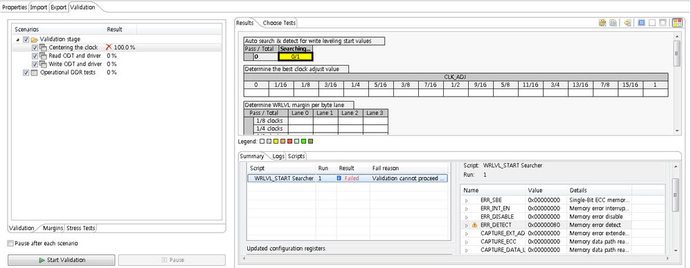

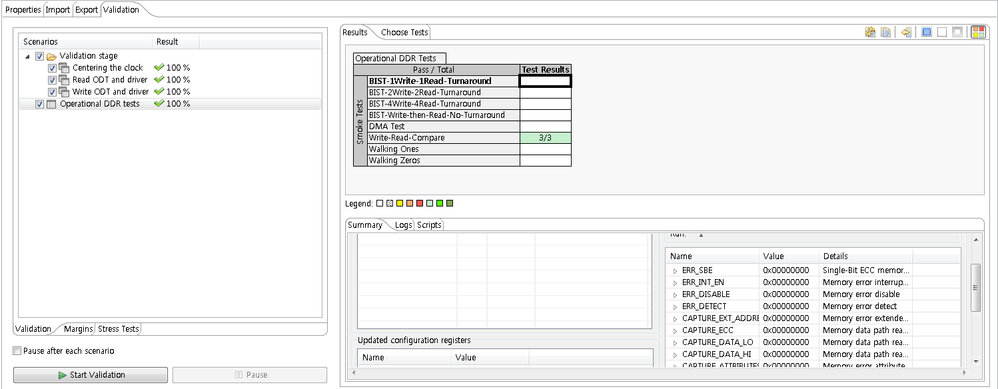

yipingwang
Hello hakjun oh,
You could use QCVS DDRv tool to validate and optimize DDR controller initialization parameters.
Would you please try your new generated ATF image on LS1043ARDB to check whether you encounter similar problem as booting from RGW?
Yiping

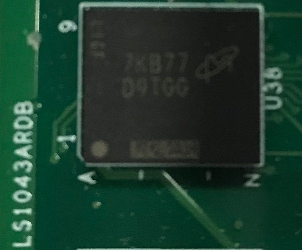

hakjunoh
Hi Yiping.
Are you trying to boot an ATF image for RGW into RDB?
This is the RDB log in the table above, but DDR_DEBUG option enabled, it looks like this:
RDB log with DDR_DEBUG

hakjunoh
Hi Yiping.
I found something while I was looking at the board. I thought it was MT40A512M88HX-093E because it was written as MT40A512M8HX-093E in the RDB source and schematic. However, I confirmed that the FBGA codes of RDB and RGW are the same.
Different results were obtained when the Validation Test was performed by matching the set values using Codewarrior DDRv. In RDB, all tests are Passed, but in RGW, all tests are Failed.
RGW DDRRDB DDR
The more I do, the more I can't figure out the cause. What more should I do?
I will continue to validate DDR configuration parameters.

hakjunoh
Yiping.
I found reason of failed DDR validation in Codewarrior DDRv. It should have set DQ values. I didn't know if there was this option.
Either way, the results are good. Now I should check if there is any DQ setting in the ATF source.
RGW DDR Validation
hakjun oh
20,338 Views
hakjunoh
Hi Yiping.
The problem has been resolved.
      return 0;
      .n_ranks = 1,
      .n_row_addr = 15,
      .n_col_addr = 10,
      .tckmin_x_ps = 938,
      .tckmax_ps = 1500,
      .taa_ps = 13500,
      .trcd_ps = 13500,
      .trp_ps = 13500,
      .tras_ps = 33000,
      .trc_ps = 46500,
      .twr_ps = 15000,
      .trfc1_ps = 260000,
      .trfc2_ps = 160000,
      .trfc4_ps = 110000,
      .tfaw_ps = 21000,
      .trrds_ps = 3700,
      .trrdl_ps = 5300,
      .tccdl_ps = 5355,
+    .dq_mapping[0] = 0x15,
+    .dq_mapping[1] = 0x36,
+    .dq_mapping[2] = 0x15,
+    .dq_mapping[3] = 0x35,
+    .dq_mapping[4] = 0x15,
+    .dq_mapping[5] = 0x36,
+    .dq_mapping[6] = 0x16,
+    .dq_mapping[7] = 0x36,
+    .dq_mapping[8] = 0x1,
+    .dq_mapping[9] = 0x21,
+    .dq_mapping[10] = 0x0,
+    .dq_mapping[11] = 0x0,
+    .dq_mapping[12] = 0x0,
+    .dq_mapping[13] = 0x0,
+    .dq_mapping[14] = 0x0,
+    .dq_mapping[15] = 0x0,
+    .dq_mapping[16] = 0x0,
+    .dq_mapping[17] = 0x0,
+    .dq_mapping_ors = 0,
      .rc = 0x1f,
Thank you very much.
