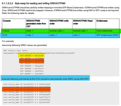

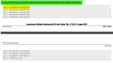

2- It's a bit confusing to Program SRKH mirror registers in U-Boot environment specified in page 152
“NOTE: CST generates the SRKH in the same endianness as SFP. To program the SRKH in an ARM core running little endian mode, a byte swap is required.”
  • should I do byte swap when using uboot commands to write memory (mm / mw) because while using ccs and codewarrior tap the byte swap was not mentioned ?
3- Is there a way to verify if my SRKH is valid within the generated headers from flex-builder (verifying using cst or any other tool) ?

"It's a bit confusing to Program SRKH mirror registers in U-Boot environment specified in page 152
Should I do byte swap when using uboot commands to write memory (mm / mw) because while using ccs and codewarrior tap the byte swap was not mentioned ?"
  • You should use the Byte swap if you applied in U-boot, but if you use CCS you don’t have to do the Byte swap for write the Value in the registers SRKH:
  • In the following table you can see the Offset of the registers of SRKH0 to SRKH7
Offset
Register name
01E8_0254
SRKH 0 255-224
01E8_0258
SRKH 1 223-192
01E8_025C
SRKH 2 191-160
01E8_0260
SRKH 3 159-128
01E8_0264
SRKH 4 127- 96
01E8_0268
SRKH 5 95- 64
01E8_026C
SRKH 6 63- 32
01E8_0270
SRKH 7 31- 0
  • In the following image in the highlighted areas you can see an explanation of when you need to use the byte swap Information that you can find in the page 307 of LSDK attached here
