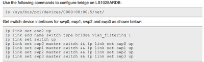

When I want to configure switch device interfaces for swp0, swp1, swp2 and swp3 acrroding to the Real-time Edge Software User Guide, I always get the following reply.
 ls /sys/bus/pci/devices/0000:00:00.5/net/
swp0 swp1 swp2 swp3
 ip link add name switch type bridge vlan_filtering 1
 ip link set switch up
 ip link set swp0 master switch && ip link set swp0 up
RTNETLINK answers: No such device
