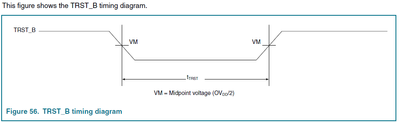

Rashmita
Hi @Bulat ,
I have few queries regarding same topic -:
1) TRST_B signal has a timing requirement as stated by Processor's datasheet as shown below. Who shall provide TRST_B with the given timing?
2) Is there any timing relation between PORESET_B and TRST_B ?
3) If we have an option to dismiss the usage of the logical gate, where shall the nRESET from Codewarrior to be connected ?
