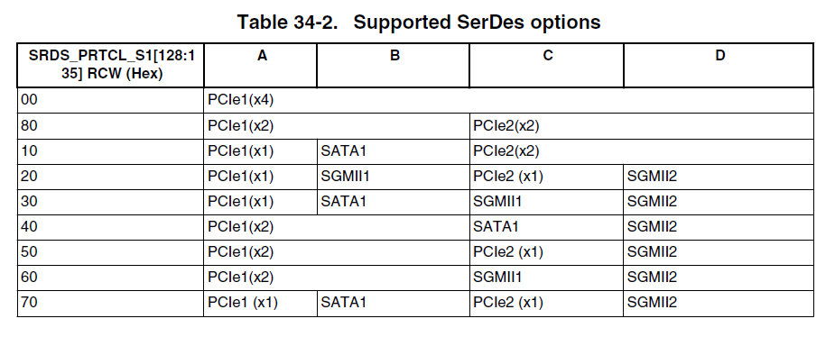

I am building SDK v1.8 for the LS1021A TWR board, using GCC 4.8.4.  I modified the U-Boot environment to boot via TFTP.  eTSEC2 and 3 work, but  eTSEC1 cannot communicate.  It establishes link at 1Gbps, however I never see Tx packets show up at the switch.  eTSEC1 sets up as eth0 in Linux, but does not work there either.
I verified that the HW is using NOR flash 0 RCW and that RCW is SSR_PPN_20.  SW2 and SW3 are at defaults.
Is there something I must do in order to get all 3 network interfaces functional?  What further information can I provide?

According to your u-boot log, it seems that you use RCW RSR_PPS_70/rcw_1000.bin, the setting of this RCW is 1 SGMII, 1 RGMII, 1SATA, 2PCIE, CAN, SAI, please refer to the the following SerDes options, that's why eTSEC1 cannot work. Please use RCW SSR_PPN_20/rcw_1000.bin in the pre-built image ISO, and please make sure that you flash the RCW on the correct bank.

Based on this tab, I wonder how can I use eTSEC0 as SGMII , eTSEC1 and eTSEC2 as RGMII, it seems like SGMII1 and SGMII2 must be configured at the same time
