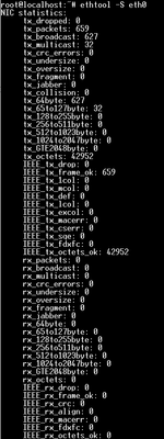

Hi, I want to configure 1-port Ethernet for SGMII communication in LS1012A.
I used the DP8367 phy chip, and configured the PFE of ls1012afrwy.dts as below.
&pfe {
  status = "okay";
  #address-cells = <1>;
  #size-cells = <0>;

However, it seems that the rx packets of eth0 are not being received.
I'd appreciate it if you could let me know if there's anything else I need to set up.

Do you use PHY DP83867? If yes, please configure CONFIG_DP83867_PHY in Linux Kernel configuration file.
In dts file, please replace reg value with your real PHY address on you custom board.
  sgmii_phy1: ethernet-phy@2 {
  reg = <0x0>;///please modify the PHY address with the real PHY address on your custom
  ti,rx-internal-delay = <0x7>;
  ti,tx-internal-delay = <0x7>;
  ti,fifo-depth = <0x1>;

Thanks, I solved the problem that way. But I have another problem, so I would appreciate it if you could also answer the link below.
