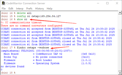

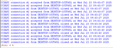

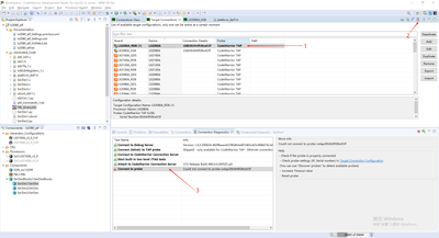

I encountered the following problems when debugging the lx2080 target board.Even if I use the network port or USB for debugging, the simulator still shows that it cannot connect.And synchronized CodeWarrior Connection Server has encountered the following issues.
Have you ever encountered such a question? I have tried many of the methods provided in the official documents as well as those available on the internet, but none of them worked.
LX2160A-RDB

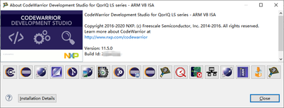

3. My CodeWarrior IDE version is:
The latest upgrade package has also been imported.

June_Lu
Please update it to the CodeWarrior IDE version 11.5.12.

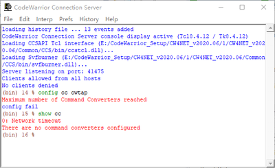

Zhoute
@June_Lu 感谢,软件已经升级到指定版本了
启动CCS后,按照您提供的输入指令,出现如下情况:
请问该如何定位问题呢?

June_Lu
用USB直接连接到PC上,用下面的命令,看是否工作正常
(bin) 8 % config cc cwtap
(bin) 9 % show cc

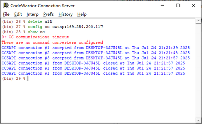

Zhoute
@June_Lu
用USB直接连接到PC上,用下面的命令,结果如下图所示:
4,865件の閲覧回数
June_Lu

@June_Lu Could you please send me the pin definitions (in the Jtag section) of the CodeWarrior Tap simulator? We are currently connecting the target board lx2080 through specific signals (TDI/TDO/TCK/TMS/RESET/VDD/GND). The CodeWarrior Tap simulator has been constantly indicating the above error.
When I click the connection button, the following problems will occur
And the CodeWarrior Tap emulator's light (RUN/PAUSE) remained orange all the time, which was not the red color as stated in the official documentation.

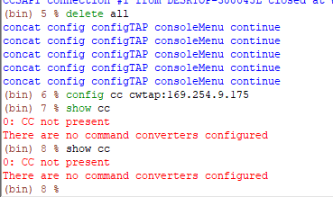

Zhoute
Hi,June_Lu,Thank you!I use your advice but not work,Below this picture is the problem,I don't know why.I searched for the relevant errors(CC not present), but failed to solve the problem.
