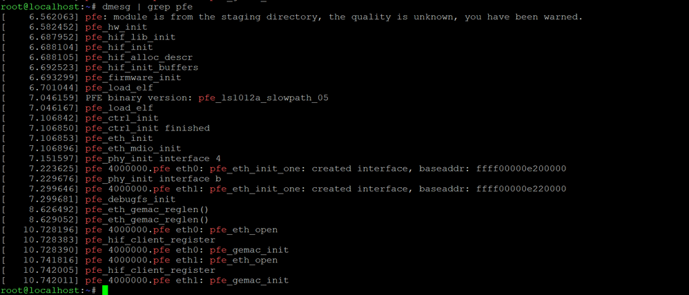

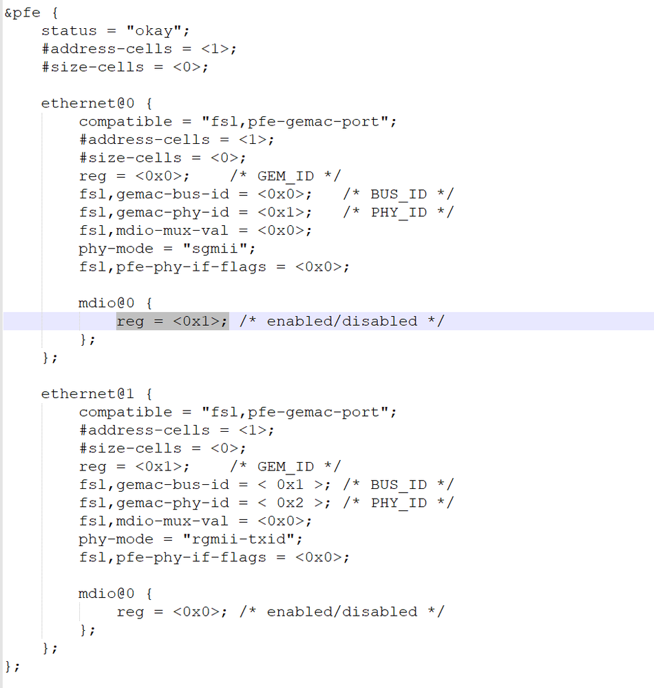

bpe
  • Only one kernel configuration option is required to enable PPFE support in the
    kernel, namely CONFIG_FSL_PPFE.
  • Stay with LSDK kernel
  • Build your firmware with NXP LSDK for the appropriate target. This ensures PPFE firmware binary is included in the image.
  • Stop PPFE in u-Boot before bootm:
pfe stop; bootm
Hope this helps,
Platon
