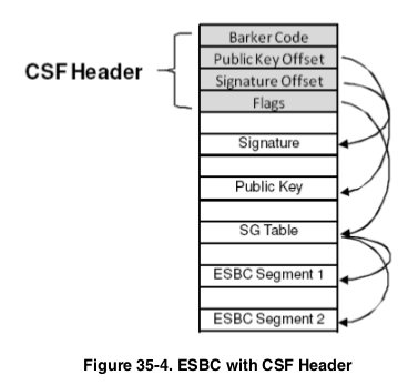

I understand that the ISBC validates the ESBC image, but how exactly does the process look? From what I understand:
  • ISBC pulls U-boot from memory at hard-coded address
  • Checks for "barker code" to ensure what was pulled is actually a CSF header
  • Validates the image based on the signature stored at the end of the image and public key available in header
Since only a hash of the private key set is fused to the SRK registers, how are the public keys and signature from in the loaded image used to validate it?

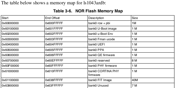

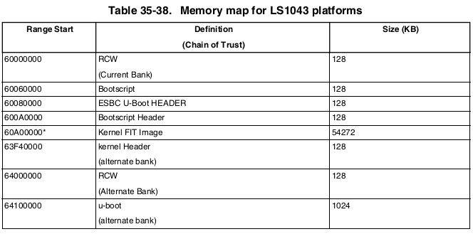

** Some parts of the documentation seem to reference them being prepended to the respective image (pg 799 of the reference manual):
while others point to them being placed in their own partition of flash (pg 1184 of the reference manual):
Further, the reference manual shows contradicting images for the partitioning of flash. The below image (pg 99 of the reference manual) shows the kernel being placed at 0x61100000 while the above shows 0x60A00000
The second image also shows the RCW and PBI being combined to fit in the first 1M of flash, while the first image has the RCW consuming only the first 128 KB of flash with no mention of the PBI.
[Platon] Fuses store a hash of the _public_ key, not the private key.
The private key is used only in signature creation, not signature
validation. SRK hash value protects the public key stored in CSF
from being modified by an attacker. Refer to LS1043RM, Sections 34.5.2 and
3.6 for  details.
An explanation of RSA cryptosystem, including methods of signing documents/files and
subsequent signature verification, can be found here:
RSA (cryptosystem) - Wikipedia, the free encyclopedia
[Platon] Headers and images they refer do not need to be adjacent.
CSF headers include pointers to the images they belong to.
[Platon] There is no contradiction. Flash maps for non-secure and secure
boot are different. If you are working with secure boot, use the map
specified in the Secure Boot ENablement chapter.
