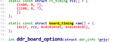

My board NG in BL2 init step.so I try to refer "QCVS_DDR_User_Guide" Debugging LS1046 DDR4 with tools codewarrior.
I saw a DDR struct "ddr_raw_timing" in my atf project ddr_init.c and it also appears in the document "QCVS_DDR_User_Guide: Click the Generate Processor Expert Code icon. ddr_init1.c".
but nothing happened when I click the Generate Processor Expert Code icon In my ls1046 CW project, and just have this files:
Am I using it incorrectly?
I haven't used DDR validation yet. codewarrior.whether it needs JTAG  debugging?

3,447 次查看
Hmc510
2GB chip: MT40A1G16KD-062E:E.  x5.
4 ships for 8G, 1 chip for ECC.
ls1046afrwy
CW Version: 11.5.0
and I want to config it as 1.8G
my current atf code:
Hmc510_0-1670202724973.pngHmc510_0-1670202724973.pngHmc510_1-1670202740613.pngHmc510_1-1670202740613.png
