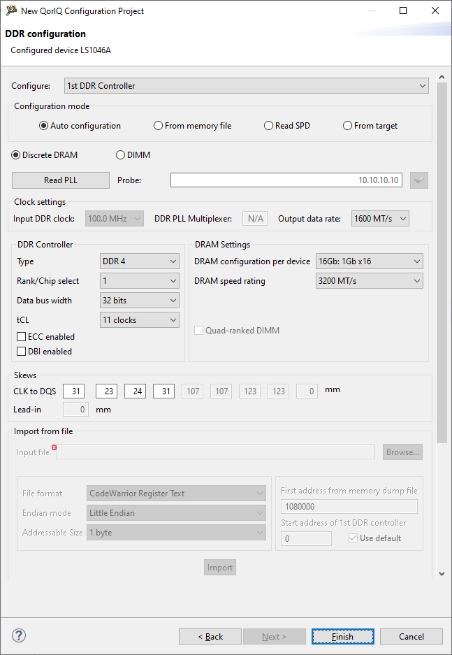

We're attempting to bring up a custom board based on the NXP LS1046A SoC. We're currently struggling with DDR initialization errors in BL2 (ATF). After experimenting with the DDR controller settings, we see one of the following three outcomes:
  1. DDR initialization and training fails with error code (debug[1] value of) 0x3002. We are unable to find any documentation on the meaning of the error bits.
  2. DDR initialization and training times out (D_INIT is not released).
  3. DDR initialization and training appears to succeed, but BL3 fails to load, with error messages indicative of memory malfunction:
    • ERROR: mmap_add_region_check() failed. error -22
    • ERROR: SD read error - DMA error = 10000000
    • ERROR: Read error = fffffffb
    • WARNING: Failed to obtain reference to image id=3 (-2)
    • ERROR: BL2: Failed to load image (-2)
    • Authentication failure

  • All SoC input voltages, clocks and resets have been checked against the LS1046A datasheet specifications for levels and timing.
  • The 800 MHz DDR bus clock (generated by the SoC) is present and there is activity on the DDR control signals.
Firmware
  • The QCVS DDR configuration settings have been checked against the MT40A1G16RC-062E IT:B datasheet.
  • All relevant CCSR registers have been checked in ATF to ensure correct strapping and RCW values.
  • Several recent versions of the ATF firmware from the qoriq-components Git repository have been tested.
  • The DDR configuration register values printed on the console have been checked against the intended settings from QCVS's generated code, and all match.
  • We confirmed that the workaround code for errata A008511, A009803, A009942 and A010165 have been applied.
  • We tried a few variations of platform clock frequency and DDR controller frequency.
  • We tried a few variations of the CLK-to-DQS skew values. (The values shown in the QCVS screenshot below are the real board values from Altium.)

DDR Initialization Code in ATF
DDR initialization code was generated by the latest version of QCVS running in CodeWarrior 11.5.0 on a Windows PC.
const struct ddr_cfg_regs static_1600 = {

Console Output
INFO:    RCW BOOT SRC is SD/EMMC
INFO:    esdhc_emmc_init
INFO:    Card detected successfully
INFO:    init done:
INFO:    platform clock 400000000
INFO:    DDR PLL1 1600000000
INFO:    DDR PLL2 0
NOTICE:  Using static DDR settings
NOTICE:  PORSR1: 207f7fff
NOTICE:  PORSR2: cf000000
NOTICE:  CLKCCSR: 0
NOTICE:  CL1KCGHWACSR: 30000000
NOTICE:  CL2KCGHWACSR: 8000000
NOTICE:  PLLC1GSR: 18
NOTICE:  PLLC2GSR: 18
NOTICE:  CLKPCSR: 0
NOTICE:  PLLPGSR: 8
NOTICE:  PLLDGSR: 80020
INFO:    Time before programming controller 30 ms
INFO:    Program controller registers
WARNING: Warning: Optimal CPO value not set.
INFO:    total size 4 GB
INFO:    Need to wait up to 2680 ms
INFO:    Reading debug[9] as 0x10101010
INFO:    Reading debug[10] as 0x10101010
INFO:    cpo_min 0x10
INFO:    cpo_max 0x10
INFO:    debug[28] 0x70006f
WARNING: Warning: A009942 requires setting cpo_sample to 0x37
ERROR:   Found training error(s): 0x3002

We have solved this issue. The cause was a combination of two factors:
1. QCVS by default generates a DQ swizzling/remapping pattern in the dq_map registers. We don't have any swizzling on the board, so we had to set dq_map[0..3] to 0 to set a 1:1 bit mapping. There is another thread about this here: https://community.nxp.com/t5/CodeWarrior-for-QorIQ/DDR4-Memory-Validation-Error-Message/m-p/606956
2. According to erratum A007864 there are problems running 16-bit data widths above 1333 MT/s. We have a 32-bit data width (2x ICs with 16 bits per IC) and it seems this also meets the criteria of A007864, as DDRv failed until we reduced the bus speed to 1300 MT/s.
I am curious why QCVS by default generates such strange DQ remapping values.
11,749 Views
DN31415

Hey DN31415 - we are using the exact same part and see exact same issues. However, if in DDR configuration tool, I try to go below 1600MT/s, I get an error. If possible, would you be able to send me your working DDR4 registers so I can compare what I'm doing wrong?
Thank you!
6,443 Views
DN31415
My original NXP account seems to have been deleted, so I am replying under a newly-created account with a different username.
I don't have the CodeWarrior project for this board anymore, but I can provide you with the generated ddr_init.c file which is compiled into ATF. I have attached the file to this post. The file contains the DDR controller registers in the ddr_cfg_regs structure.
In addition, we changed the MEM_PLL_RAT field (DDR clock) in the .rcw file to 13 (meaning 13 * SYSCLK, yielding 1300 MHz assuming SYSCLK is 100 MHz).
Please double-check the other DDR controller settings in this file for compatibility with your board. I hope this helps!
