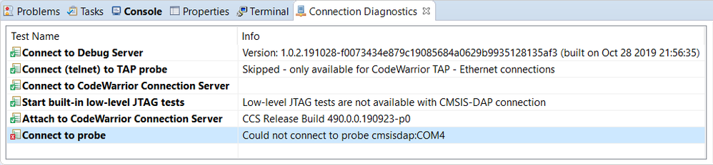

I have a 1043ARDB and I want to establish a connection with it through CodeWarrior using the serial connection with the RJ45 to DB9 cable on the UART1 port and I am having some issues with it. I can connect and communicate with the board using Tera Term and PuTTY with the same connection but when I try to do the same with CodeWarrior, it doesn't work.
I already set up the CodeWarrior project to how it was referenced via the CWARMv8TM.pdf in section 6.9 "I/O support", duplicated the LS1043A_RDB in the Target Connections tab as well as set the USE_SAFE_RCW to true in the Target Initialization File in the duplicate board but when I run the Connection Diagnostics, I get this:
Any help is appreciated. Thanks!

This is what I get from the console:
ccs_open
    ipaddr = 127.0.0.1
    port = 41475
    timeout = 300
    serverh = 0
    ccs_open; ccs_error = 10
    Error message: Connection refused
ccs_open
    ipaddr = 127.0.0.1
    port = 41475
    timeout = 300
    serverh = 0
    ccs_open; ccs_error = 0
ccs_get_cc_config

Edit: I also get this error when I run the debugger:
Target connection failed. Please re-check the settings.
Processor: LS1043A
Probe: CMSISDAP (4)
Additional error details:
[CCS: TAP USB open failure]

Hello Franklin Turner,
In "Target Connection Configuration" panel, no need to configure CMSIS DAP Connection"Serial number", please only select "CMSIS DAP", JTAG Speed as 6000 kHz.
Please refer to the attached screenshot.
Yiping
