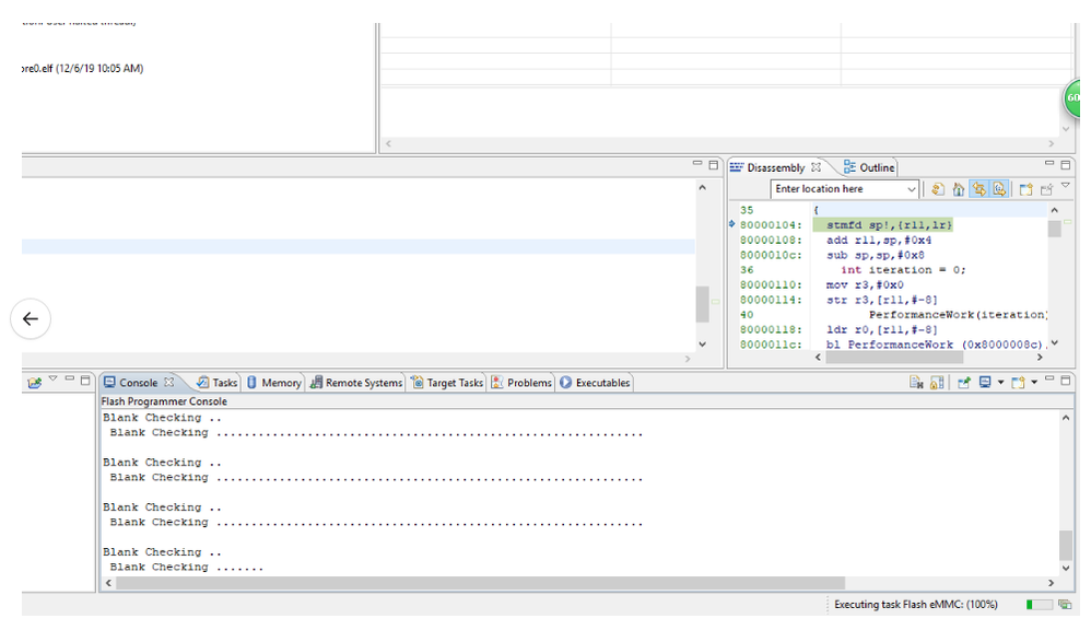

So my standalone board of ls1021a which has an external eMMC, DDR no SD card slot option. I want to test the uboot binary on the LS1021A-TWR eva board via JTAG interface first then flash to my stand alone board. I want to make sure
(1) if SD card on my eva board and eMMC on my standalone board are the same thing in terms of RCW boot source.
(2) I had encountered this error when I tried to flash into SD card on the eva board
7 Replies
3,040 Views
ufedor
The CodeWarrior Flash Programmer is trying to load driver to the target's SDRAM and it appears that the SDRAM is not initialized or not operational.

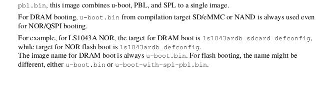

I was trying to use the method described in AN12270, Section 2 using lsbp.tcl because seems like you guys have so many different kinds of method.
I failed to use AN12270 because i do not know what is the u-boot.bin they are talking about
The one I have is called
uboot_ls1021atwr_sdcard_qspi.bin
which I generated from LSDK
I am going to switch to the method you recommend now

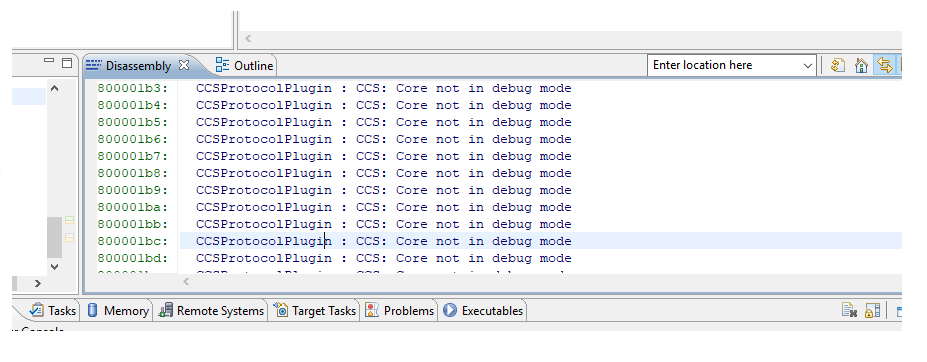

jiye
Contributor V
be noticed that since I need do some PCB modifications that is why right now I am testing on my eva board with boot source SD card then once I execute the task it keeps doing blank checking is this normal ? It's been doing for half an hour now
then says
