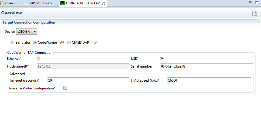

I am using the default LS1043A_RDB target connection configuration which is provided in CW. version of CW is:

This is the diagnose result, please help to have a look.
Also, the connection configuration is:

In the future please attach big texts instead of "inline".
Is the board capable to boot?
6,423 Views
uncoldice
Thank you for your reminder ufedor‌.
Root cause is that I didn't stop the U-Boot count down, and the board goes to a 32-bit Linux kernel before my debug.
6,424 Views
ufedor
Please run "Diagnose Connection" and provide the log
