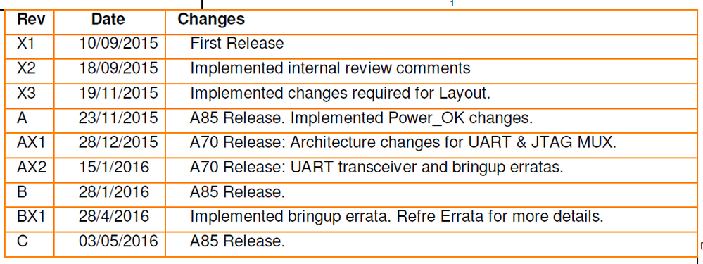

I just got LS1012A RDB, It's a rev A. I have not found what the difference between the board revisions are.
Where can I find information regarding the difference between boards?
タグ(1)
1 返信
1,373件の閲覧回数
alexander_yakov
Board revision history is usually described at the first page of board schematic, here is a screenshot:
