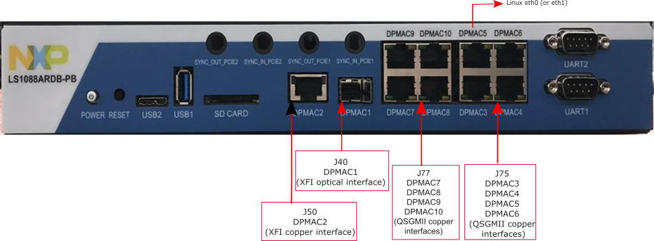

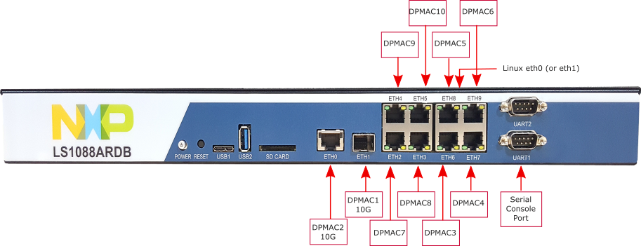

In Linux, only one MAC is created by default as a standard kernel Ethernet interface. This interface is named eth0 by default (or eth1 if PCI Express network interface card is discovered first). The following figure shows the Ethernet port (ETH8) that eth0 (or eth1corresponds to, on LS1088ARDB.
The following figure shows the Ethernet port (DPMAC5) that eth0 (or eth1corresponds to, on LS1088ARDB-PB.
Only one interface is created by default because in DPAA2, Ethernet ports need not be associated with Linux kernel Ethernet driver instances. For example, Ethernet ports can be assigned as ports on switches or can be allocated to user space. Furthermore, these associations can be made dynamically.
