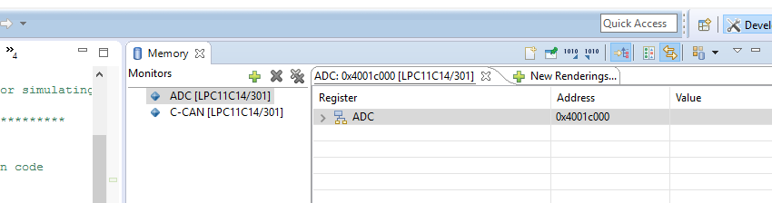

In Keil it's possible to see multiple peripheries at the same time.
Q: Is it possible to do the same in LPCXresso ?

Thanks Con,
The link describes moving/docking view which is I think in LPCXpresso case called 'Memory'.
What I am trying to achieve is multiple instances of 'Memory'. To see at the same time ADC and CAN registers. I do not understand what part of the 'Memory' view I should drag.
Would you please post a screenshot showing 2 peripheries at the same time as I did with Keil uVision ?

Sorry, I got that wrong. You can create another memory view by clicking on the "New Memory View" icon on the memory view toolbar. Then you can do as I said in my first reply. Its probably not as convenient as Keil, but it does work.2017-02-27 02.29.03 pm.png

Perfect world Con, thank you !
Even though all views setting must be done again for each new debug session it is the step forward. I really think I will switch to uVision as this feature - remember settings between debug sessions - is important when debugging more complex code :   how to store settings between debug sessions

Yes. First click on the Peripherals you want to display, then you can drag the view to separate it from the others, as described in the Eclipse docs here:
