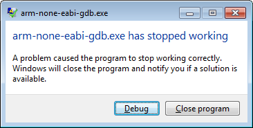

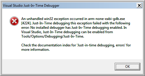

I'm working with LPCxpresso IDE 8.2.2 and JLink debugger with no problem on a LPC1788. I can compile & debug the LPCOpen projects as expected and also migrate C applications to C++. The problem is when I try to debug a basic (1 task) freeRTOS in C++. The compilation ends successfully but here's the error dialog when gdb starts
then, when I press the Debug button...
and finally... no debug sesion is started
Any hints? How can avoid this issue?

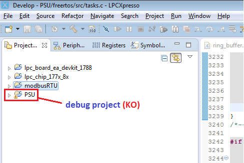

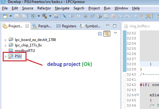

It seems that no matter if the code is written in C or C++. I'm working with last link plugin (4.1.2.201701141320) and jlink driver (v6.14). The issue seems to be related to the number of opened projects. If I just imported the PSU (lpc_xxx projects are necessary to build) everything goes well.
However in the next scenario I'm not able to debug the PSU project, as shown in the previous post.

Lack of memory problem maybe? (I'm running on W7 Professional 32-bit and 3GB RAM)
I will continue investigating anyway...
