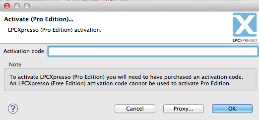

Within the LPCXpresso IDE product select:
  • Help -> Activate -> Activate Pro Edition
  • and enter the supplied activation code.

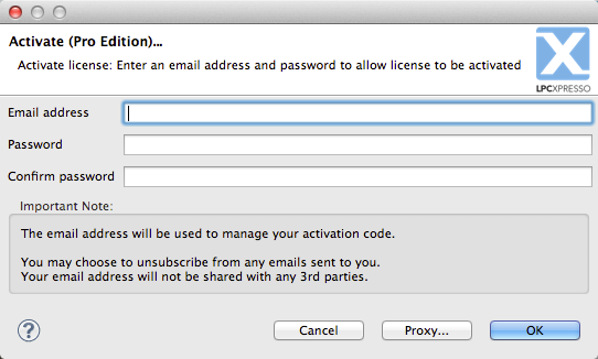

  • enter a valid email address
  • enter a password to be associated with this Activation code
The email address supplied for the first activation is used by Softworkz, our license systems supplier, to send a Welcome Email with the Subject 'myLicense Portal Information'. This Welcome mail is important and should be kept by the user or administrator.
The supplied password is now associated with this activation code and should be kept safe as it is required to deactivate (remove) or to reactivate LPCXpresso IDE (Pro Edition).

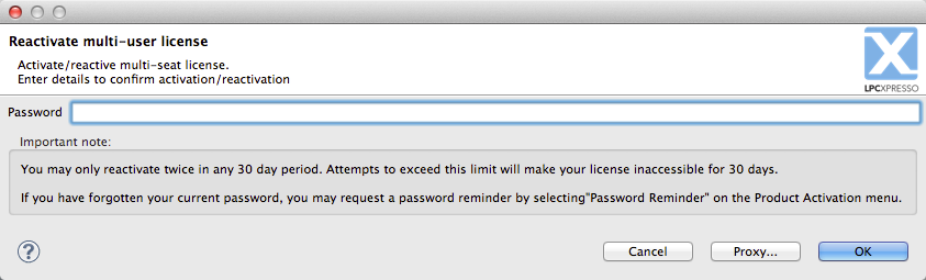

Multi Seat Activation Codes
Multi Seat activation codes allow LPCXpresso IDE (Pro Edition) to be activated on multiple machines, until all seats have been used. So a 5 seat Activation code allows LPCXpresso IDE (Pro Edition) to be activated onto 5 unique computers. After the initial activation (as described above), all subsequent installations simply require the password that has been associated with the Activation code.
Within LPCXpresso IDE product select:
  • enter the Multi Seat Activation code
  • enter the password that has been associated with that Activation code.
