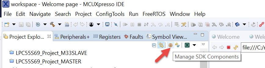

To add other module to a certain project, I suggest you use "manage SDK component " feature.
But please note, adding/removing components could potentially break your project. You need be very carefully.
