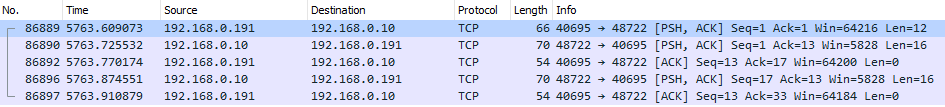

I'm running a LPC4357 on a OEM board from embeddedartists.com
I have a LWIP implementation based on LPCOpen where I receive commands from a client computer (LPC is server) and response some data to the client.
My Problem is now, that if my client send one command to the server, the server send the response two or more times.
The Wireshark screenshot shows the bevaviour: Client (@191) requenst some data (No. 86889) and the server (@10) responsed two times (No. 86890 and 86896).
The strange thing is: This behaviour only happens if I'm using the debug mode or if the client is far away. If I build a release programm and the client is my Computer next to the server I have a perfect communication (1 command -> 1 response).
On my main loop i call a function processNetwork() where all the network stuff is done (code below), this is part of the LPCOpen examples.
I tried different call intervalls for this processNetwork() function (as soon as possible, 10ms, 100ms, 250ms) but without any solutions to that problem.
I also call tcp_recved() at the end of my tcp_received() function after I processed the incomming data.
As a reason of the different behaviours between Debug and Release builds I think the problem is any kind of timing issue.
I would be happy if you have any idea what the problem could be or in which direction i have to search for.

There is important to isolate the issue, could you try using only (without modifications) the webserver example from LPCOpen?
I want to know if there is a software or hardware issue.

the advice was good. I cross checked my code with the Echo example and found a memory leak.
I didn't free all received pbufs and thereby I received the package twice or more.
Thanks for the help / hint.
