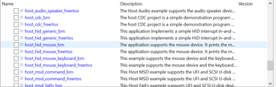

Hello @Arularasan
There is USB HOST demo under SDK, you can refer to, download from:
https://mcuxpresso.nxp.com/en/select

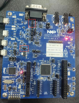

Hello @Arularasan
The default USB of this demo is USB0, if you want to use USB1, you need change some code, and jumper on board.
Change code as below:
.2   Update USB host demo: USB0->USB1
Taking usb_host_hid_mouse demo code as an example, to switch to USB1, modify the macro definition in usb_host_config.h as follows:
#defineUSB_HOST_CONFIG_KHCI (0U)
#defineUSB_HOST_CONFIG_EHCI (0U)
#define USB_HOST_CONFIG_OHCI (0U)
#define USB_HOST_CONFIG_IP3516HS (1U)
Jumpers refer to readme.txt, I also tested on my side, works well, jumpers as below:
