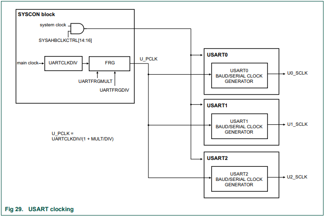

hai
        in my Lpc824 have 3 uart protocol   . can i use the uart0 in 9600 baud rate and the uart1 as 115200 , if it is possible to use different baud rates in single code
Thanks&Regards
Aravind P
标签 (6)
1 回复
3,305 次查看
soledad
Yes, it is possible.
 All three USARTs use a common peripheral clock (U_PCLK) and, if needed, a fractional baud rate generator.
In asynchronous mode, it is necessary to configure the baud rate divider BRGVAL in the USARTn BRG register and the serial clock is Un_SCLK.
