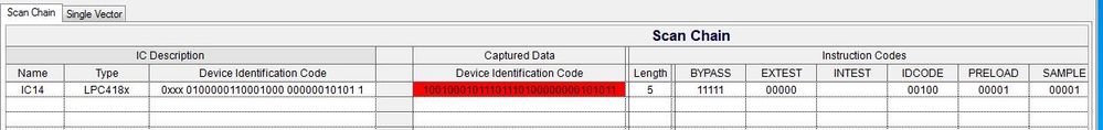

ziehnert
Hello Mr. Jun Zhang,
see attached the screenshot of the wrong ID-Code.
We read the Code 10010001011101110100000000101011.
The manufacturer code is ok, but the device id is wrong.
ID_Code_read.JPG.

ZhangJennie
We are checking this issue with doc team.
May I understand, on your side both version number( yours is 1001) and part number ( yours is 0001011101110100) are not match. Correct?
Could you please hep to confirm the problem is in some chip or all chips?

ziehnert
this is correct. We read the correct manufacturer id 00000010101, but the part number is incorrect. The version number in the bsdl file is 0xxx, we read 1001.

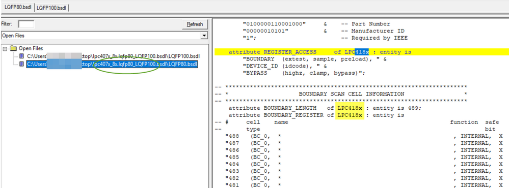

ZhangJennie
Hi Jan
So this issue is on some chips but not all chips.
in the BSDL file, the part no. is LPC418x, obviously it not right, I'll inform doc team for this. But it's not important content for BSDL file, it's just like a label, actually, customer can easy replace all LPC418x to any he wanted part No.
So the customer can use this file with replacing the label to LPC4074.
Please let me know if this is workable for you. Once I get feedback from doc team with the fix. I will let you know.

ZhangJennie
Hi Jan
Are you sure you use the same LQFP80.bsdl  for LPC4078 80pin chip, you can capture the correct data?
Because if open LQFP80.bsdl, the part no. is LPC418x

ZhangJennie
Hi Jan,
Just got feedback. LQFP80.bsdl  works for both LPC4074 and LPC4078 80pin package.
If the same LQFP80.bsdl can support  LPC4078 well, it should also works for 4074.
Thus we wonder the problem is on your SW side.
or, send me the LQFP80.bsdl  file you used with LPC4074 one year ago. we can help to compare.

ZhangJennie
Jan Ziehnert
Thank you for contacting us.
According to your description: "
I read an incorrect ID-Code and any pin operations (set, read) will not work correct.
The BSDL file names the type LPC418x.
Can you please send me a photo or screenshot of this problem?Thanks.
