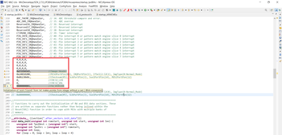

Hi all,
My original image starts from location 0x00002000. I want to add image header data(Highlighted in a rectangle) at a 0x00002100 location in flash so I have added it in the g_pfnVectors section in the startup_lpc804.c file. By adding it I got a warning as shown in the below image.
1. How to remove this warning?
2. What should be the proper way to add the header data 0x00002100?

Hello bhavind,
This is not very easy for MCUXpresso, please refer to my below steps, I place the image header at 0x100, the same for 0x2100.
I attached the steps as picture, also the project, you can refer to.

Hello bhavind,

Bhavin_Dhulkotiya
Thank you! @Alice_Yang
Is there any way to add this header in the startup.c file instead of using modified .ld file?

Hello bhavind,
As far as I know, there isn't .

Hello bhavind,
If your project start from 0x00002000, I don't think you can add anything in 0x00002100, because
it over write vector table, you can see .map file the real memory used:
And there is no image header in LPC804 boot flow, why did you want to add it ?

Bhavin_Dhulkotiya
Hi @Alice_Yang
We want to add the header for the Secondary Bootloader. And we want to add it at the 0x00002100 location.

Hello ,
Do you mean Secondary bootloader use memory 0x0000 to 0x1FFF,
application start from 0x2000.  Add image header into secondary bootloader project?
If yes, the two projects use overlapping address.
Alice

Bhavin_Dhulkotiya
@Alice_Yang
We want to implement as shown below image on LPC804. Please find the reference document here
Now I want to add a header at 0x00002100.
