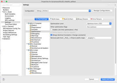

However, if you make the one simple change of changing the compiler optimization level from -o0 to -o2 in the project settings and run the same test you will now find that the SHA256 result is in fact incorrect! (Incidentally, I chose -o2 rather than -o3 as I have previously found issues with the USB examples at -o3)

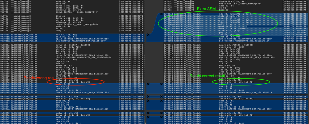

Firstly, by single-stepping at assembly level, I checked that all the reads and writes to RAM and the SHA engine control registers happen in the same order and with the same data regardless of the optimization level. So it seems not to be a logical problem.
Moving on from this I created two test cases differing only in a tiny number of (seemingly insignificant) assembly instructions added into the code at a strategic place. These assembly instructions will cause the SHA to work properly at -o2. The code for the two examples was carefully crafted and linked to be identical apart from the inserted assembly code (I will explain how to recreate my findings below). This allows side by side diff of the trace files and highlights any differences between the traces. The trace files are run_fail.txt & run_working.txt they can be compared side by side with a tool such as 'meld'. The files run_fail_annotated.txt & run_working_anotated.txt are the same files but with some hand-added descriptions.
I include instruction trace dumps on for the working and failing examples both created at -o2. There is a lot of preamble before getting to the SHA but once the trace gets to pc = 0x370c the fun starts.
Looking at the failing example
0x78038 -> 0x780e0 Entering HASHCRYPT_SHA_Finish function
0x2fc2 Entering memcpy (copy SHA data into place)
0x370c -> 0x372e the data to be sent for SHA is being copied in to RAM @ 0x2002ff08 & 0x2002ff0c
NO FIX
0x780e4 -> 0x780e8 Wait for SHA engine to be free
0x7806e -> 0x78076 Configure and start the SHA engine
0x78078 -> 0x7807c Wait for SHA to finish
0x7807e -> 0x78088 Do the output size checks
0x7808c -> 0x78090 Wait for SHA to finish (again!)
0x78092 -> 0x7809c Read out first word of SHA --- it is incorrect 0x323b4b63
Looking at the working example
0x780e4 -> 0x780f8 Inserted fix code
0x780fa -> 0x780fe Wait for SHA engine to be free
0x78092 -> 0x7809c Read out first word of SHA --- it is correct 0x6893a08c
Side by side diff shows that up until the added asm code the traces are identical. After the "fix" things are the same until the readout of data.
Note the "fix" does corrupt the stack but not in any region that is then used before the SHA readout.
The exact instructions in the "fix" are important! I spent a good deal of time finding this minimal example. Originally I tried inserting nop instructions and found that in places this could make things work. However, closer examination showed the nop instructions were simply forcing the c compiler to produce different code in this vicinity (mostly preventing inlining). It was one of these "differing" sequences that gave me the inspiration for the eventual minimal "fix"
SO IN CONCLUSION...
Clearly, this "fix" is not a real solution as I have no real idea why this change makes things work. However, having spent most of my life in ASIC design my hunch is that you have a data flushing bug. The data destined for the SHA hardware assist has not in fact reached system memory by the time the HW assist engine starts its work.
Note the "fix" writes to memory regions at a close but not the same address as the real data. My hunch would be that this forces a flush.
The original -o0 code does many more memory and code accesses between the write to memory and the trigger of the SHA engine. And so by accident causes a flush.
Of course, there is no way to confirm this for certain from where I stand. However, It is obvious, even from your own example code, that you have a problem and I hope this bug report helps find it and create a real work around.

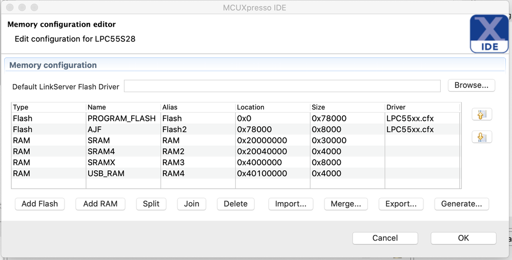

In order to be able to modify the one c-function of interest and not find that the linker had placed many functions in different places making side-by-side comparison extremely difficult. I remapped the HASHCRYPT_SHA_Finish in drivers/fsl_hashcrypt.c to a location higher in the FLASH memory.
Firstly I created a modified address map by shrinking the standard PROGRAM_FLASH region to be size 0x78000 and creating a new region at 0x78000 of size 0x8000
Secondly, I decorated the HASHCRYPT_SHA_Finish function with
__attribute__ ((section(".text_Flash2")))
status_t HASHCRYPT_SHA_Finish(HASHCRYPT_Type *base, hashcrypt_hash_ctx_t *ctx, uint8_t *output, size_t *outputSize)
Now I can change HASHCRYPT_SHA_Finish with minimal impact on the rest of the code

I noticed that there is also an SDK example that checks results. It is called lpcxpresso55s28_mbedtls_selftest. Sure enough, when I run it out of the box all tests pass. However, when I change to -O2 it then fails for SHA!
  SHA-1 test #1: failed
  SHA-256 test #1: failed
  SHA-384 test #1: passed
  SHA-384 test #2: passed
  SHA-384 test #3: passed
Note SHA>256 is done in software (no hardware assist).
