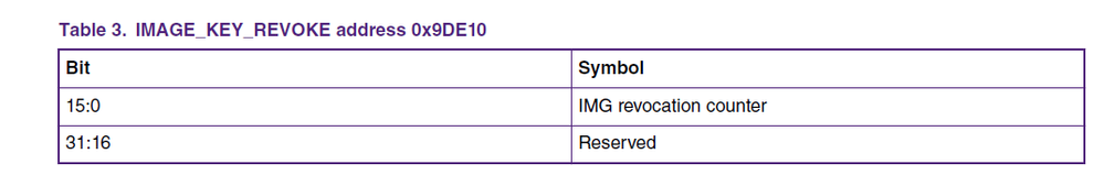

   I find that IMAGE_KEY_REVOKE of CFPA  has 4 bytes from address  0x9DE10,  but it only need two bytes; so i shall write 3C C3 00 00 from  address 0x9DE10 ?

  3、 I find that IMAGE_KEY_REVOKE of CFPA  has 4 bytes from address  0x9DE10,  but it only need two bytes; so i shall write 3C C3 00 00 from  address 0x9DE10 ?

3. From  AN12283 we can see, in IMAGE_KEY_REVOKE, the 31:16 reserved, only two bytes (15:0) are used as
IMG revocation counter:
