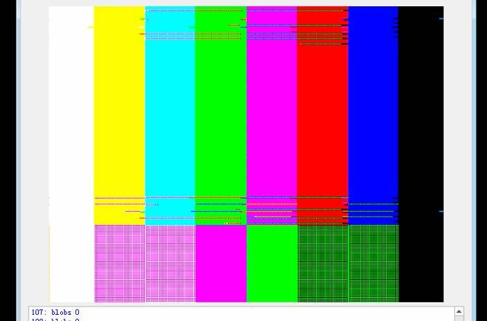

I use same program struct like sct flexible camera solution AN11365, using lpc4350,the board m4 clock is 192mh(192/8=24MH),and change cmos chip to Ov10635, and transfer image via usb. the problem is the picture always with horizon line go from up to down (for high frequency) or from bottom to up(for low frequency). the ov10635 normal working xclk is 24MH, but only when I reduce the xclk to 12MH and below , the picture will ok.
it seems that the href blank time is not long enough to deal with interupt ,which reload dma configuration.  hope somebody can help me.

I checked the LPC43xx AHB multilayer matrix configuration, which using a round robin arbitration scheme to select which AHB master occupied the bus slave.
Follow with you analysis, there exists AHB bus conflict. Where could be the root cause?
GPDMA and USB module compete to gain the external memory access right.
If so, it also could explain disable USB module interrupt make the GPDMA works normally(avoid AHB conflict between GPDMA vs. USB).

I think I already find the real reason . at the beginning, we think the gpio speed is not fast enough. but when I colse the usb interrupt, the gpdma  did not lose data anymore, so the real problem is the the usb transfer interrupt affect the gpdma transfer. the gpdma burst request is from SCT input5.
but even I moved the usb interrupt function to M0 ,or move SCT interrupt to M0, nothing happened .
so I think something conflict between gpdma  and  usb.
I need your help.

With your description, the USB interrupt service will affect the gpdma transfer.
I checked the AN11365 source code, the GPDMA initialize code was called at SCT IRQ.
Could you try to enhance the GPDMA and SCT interrupt priority higher than USB interrupt?

I think the main problem is the AHB bus conflict.
I select AHB M1 for source data and Select AHB M0 for Memory, I think
USB also use M0 or M1, so this cause conflict. and I tried to use AHB M1
for memory, the situation became worse.
I also tried to move interrupt to the M0 core side, there was no effect.
so I think that is not a conflict of the interrupt, it is a conflict of
AHB bus.

There seems when OV10635 works at 24MHz, the gpdma doesn't have bandwidth to transfer all data to USB.
When slow down the bandwidth requirement, the gpdma will transfer all data to USB.
What's the GPDMA working clock? 192MHz?
What's the GPDMA burst size? 256?

The root cause is because the GPIO module is not a fast peripheral.
If there using higher frequency to transfer data from GPIO register to memory, the GPIO register doesn't updated the correct data from OV10635. There will cause DMA read the incorrect data  and transfer to LCD display buffer.
Then LCD will read the incorrect data and display abnormally.
Thank you for the attention.
Mike
