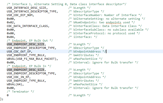

I am working on a custom board with LPC4088 on it. I am using USB1 in device mode to communicate with the PC software in order to update firmware.
Initially I was using LPCOpen's usbd_lib_cdc  program to communicate to PC using terminal. So based on CDC code I have now changed it to vendor-specific USB code which is enumerated & recognized by the PC using our driver.
When I try to connect it to PC software it gets connected. The PC software sends the first char to start communication, which is read by the USB device successfully but when I try to write anything back, it fails to do that.
I observed that endpoint IN handler never gets called. And there is no IN packets when I call WriteEP().

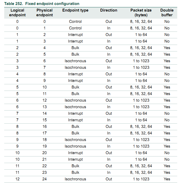

priyankb
hey jeremyzhou‌,
I have solved the problem. Changing endpoints worked. I have a doubt about fixed endpoints configuration in the user manual. What does it mean? Does that mean a particular endpoint is used with a specific configuration only?ep.png

jeremyzhou
Hi Priyank Bhatt,,
1) Does that mean a particular endpoint is used with a specific configuration only?
-- Yes, it does.

priyankb
hi jeremyzhou‌,
Then how come CDC demo use endpoint 1 with bulk configuration. This is confusing.
5,676 Views
jeremyzhou
Hi Priyank Bhatt,
After testing and confirming with AE team, it should follow the reference manual.

jeremyzhou
Hi Priyank Bhatt,
Definitely, it sounds contradictory and I'll reply you later after confirming with AE team.
