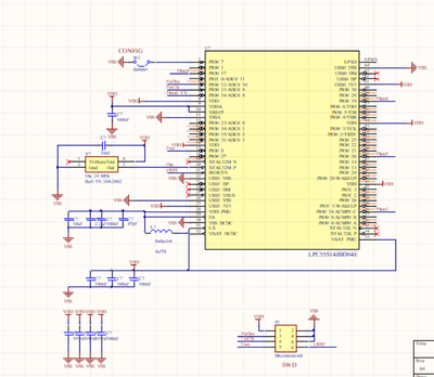

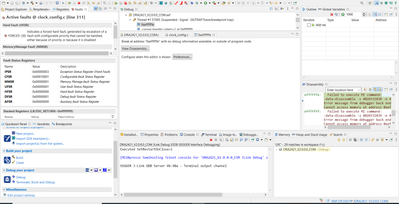

Hi all, I'm using the LPC55S14, and I can't program it, I get a message saying : Break at address "0xeffffffe" with no debug information available, or outside of program code.
If someone could tell me where the problem can come from.

Additionally, could you tell me how are you handling the PIO_5?
The state of port pin PIO0_5 at Reset determines the boot source of the part or if the handler is invoked.
If you have more questions do not hesitate to ask me.
Omar
4,919 Views
Nadia
@Omar_AnguianoPIO0_5 is in pull-up.
Should it be at 3.3 V?

@frank_m @Omar_Anguiano When I tried to load the programme, I got a file named: script.jlink, which contains:
ExitOnError 1
r
h
loadfile "C:\Users\Nadia\Documents\MCUXpressoIDE_11.3.1_5262\workspace\LPC55S14_Project\Debug\LPC55S14_Project.hex" 0x0
qc
qc
4,883 Views
Nadia
@Omar_AnguianoThe problem persist. PIO0_5 is at 3.3V
4,954 Views
Nadia
When I try to program it, I get this message: Break at address "0xeffffffe".
