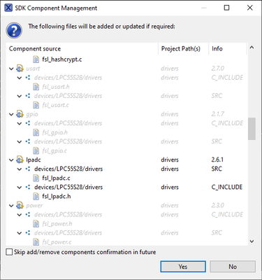

simone_acciarri
I saw this window
And as you can see, usart driver is clouded (but it's actually version 2.6.0).

lpcxpresso_supp
Hi Simone,

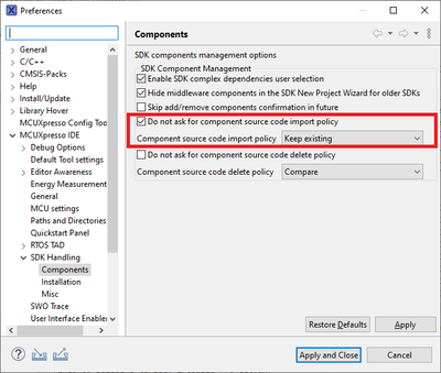

In the mentioned window you see a new version of the file as the SDK have been updated to 2.13 version. If you click on Yes, do you see the window specified by us in the previous comment?
If not, please verify if option "Do not ask for component source code import policy" is checked in Preferences -> MCUXpresso IDE ->SDK Handling ->Components.
If it is, uncheck it and select "Component source code import policy" on "Compare", apply changes and try to refresh the SDK components again.
MCUXpresso IDE Support.
