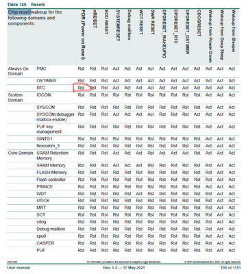

Matthias9265
At this time, the RTC is resetting to 1/1/1970 when VBAT_PMU is connected to 3V and the remaining supply inputs are cycled. It continues to count when the running, but will not hold time through a main supply interruption.
Any thoughts?
6,843 Views
xiangjun_rong
I copy the reset Fig from UM11295.pdf, as you see that the POR(Power On Reset) also Reset the RTC, that is why that the RTC can not hold time after main supply is powered.
I suppose it is a bug, the POR should not reset RTC.
Hope it can help you
XiangJun Rong

Matthias9265
Thank you for the response.
Is there a method to disable the POR for the RTC?
6,727 Views
xiangjun_rong
Unfortunately, there is not a method to disable the POR for the RTC, I think this is a bug.
